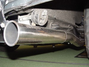

if the end pipin was a tad longer just wack this on the end
as shown below here
f**k the back box, your car wud be loud as fook
However i do warn you its illigal :)
