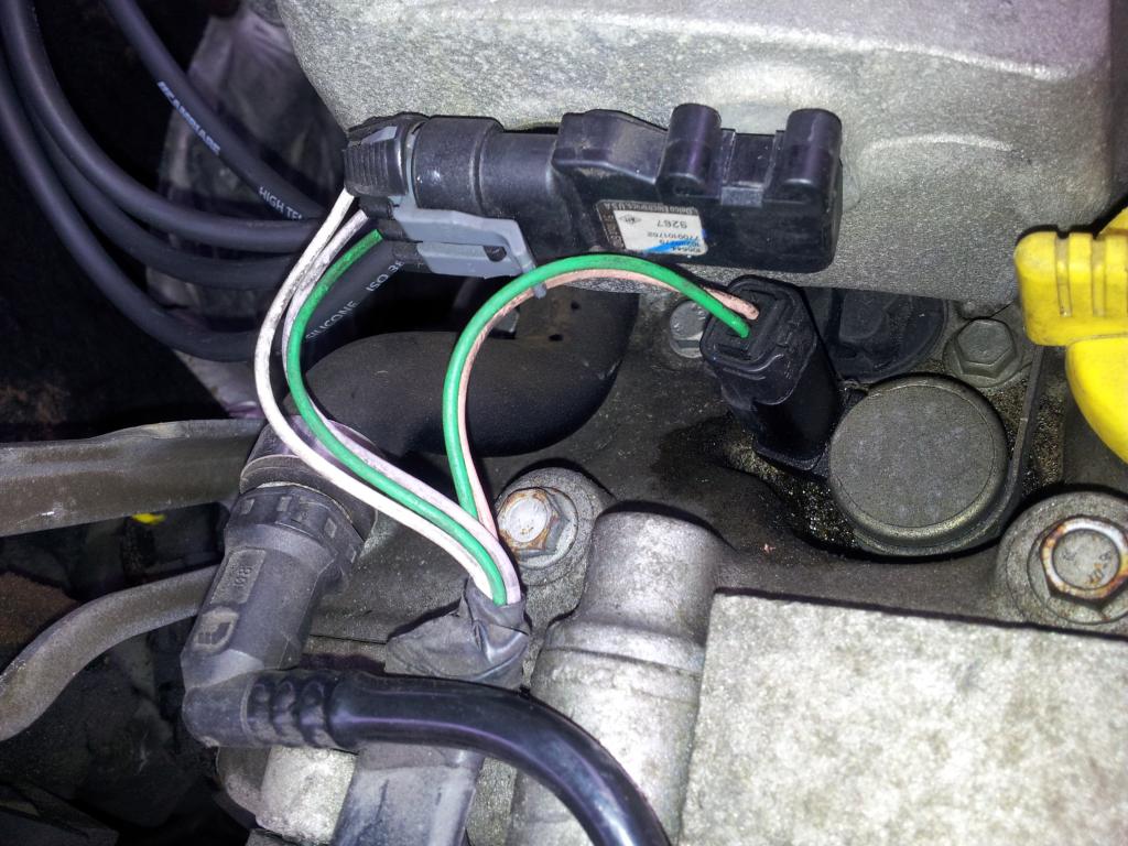

What sensors are these?
Hey guys what sensors are these?
Would they cause the car to stall if they are loose? Or shorting out?
They are found on the left of the throttle body plenum on a 172.
The black wiring housing that runs up the left side of the engine, that holds the wiring for these two sensors, could be the problem?
Top one is map sensor which provides the main engine load value to the ecu so it knows how to fuel and spark the engine, the bottom one is not a sensor it is the dephasor solenoid which activates the variable cam timing.
If the map sensor signal is incorrect for any reason, the engine wont run well if at all.
Ah ok, so the map sensor may be the cause for my problems.
would it throw up a fault code?
I have the regular issue people have been complaining about, but the seems to be no definitive fix.
It stalls as its coasting upto junctions, stalls in neutral, in gear, clutch down or up.
also I have trouble starting it up, sometimes 11 times to get it to catch.
Also it does have an occasional misfire, feels like its lost a cylinder or two, then you can't apply any power, so when you slow down enough it stalls. But it fires back up just fine following that.
would that MAP sensor cause those running problems?

* manifold absolute pressure sensor. - map sensor. - this is what I think may be the problem, as above moving the wiring housing, causes it to stall. The sensor itself may be ok.
So I'm thinking MAP sensor is dodgy, or the wiring harness that trails down the side of the engine may be earthing out, see in the above photo, it has electrical tape holding the wiring together, is that standard?
