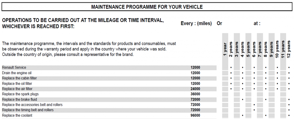

What service @35k please
Hi my car is due a service and its on 35k what would this involve other then
Air filter
Oil
Plugs
Remember Renault referring to it as a big'ish service
Thanks Graeme
I'd be interested to know the cost of this as mine is due a service at the end of the year. And if you go main dealer or not.
Cheers
So, from the above extract the service intervals are as follows:-
oil & filter 2 years or 12k miles
cabin filter 2 years or 12k miles
air filter 2 years or 24k miles
spark plugs 36k miles
brake fluid 4 years or 72k miles
timing any aux belt 6 years or 72k
coolant 4 years or 96k miles
OP - when was your car last serivced and what service did it have?
