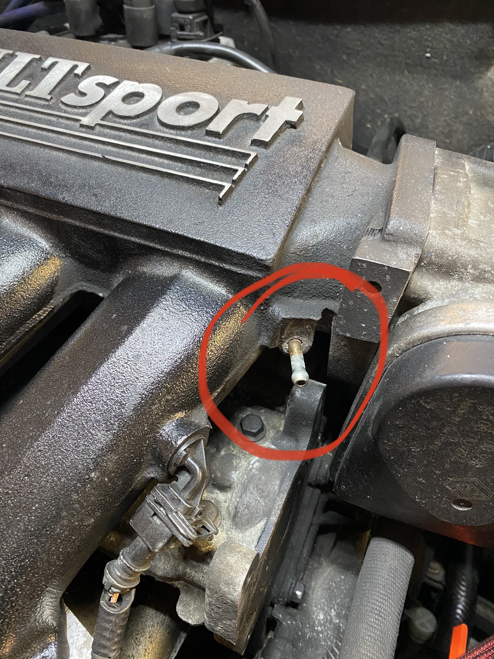

What should this be connected to guys??
DaveDreads aka Philomena Cunk aka Barry Shitpeas ClioSport Club Member Golf PD130, 172 Apr 8, 2022 #3 You don't need it, block it off.
DaveDreads aka Philomena Cunk aka Barry Shitpeas ClioSport Club Member Golf PD130, 172 Apr 8, 2022 #5 You'll get a high idle from having a vacuum leak, it usually jumps to 3k rpm.

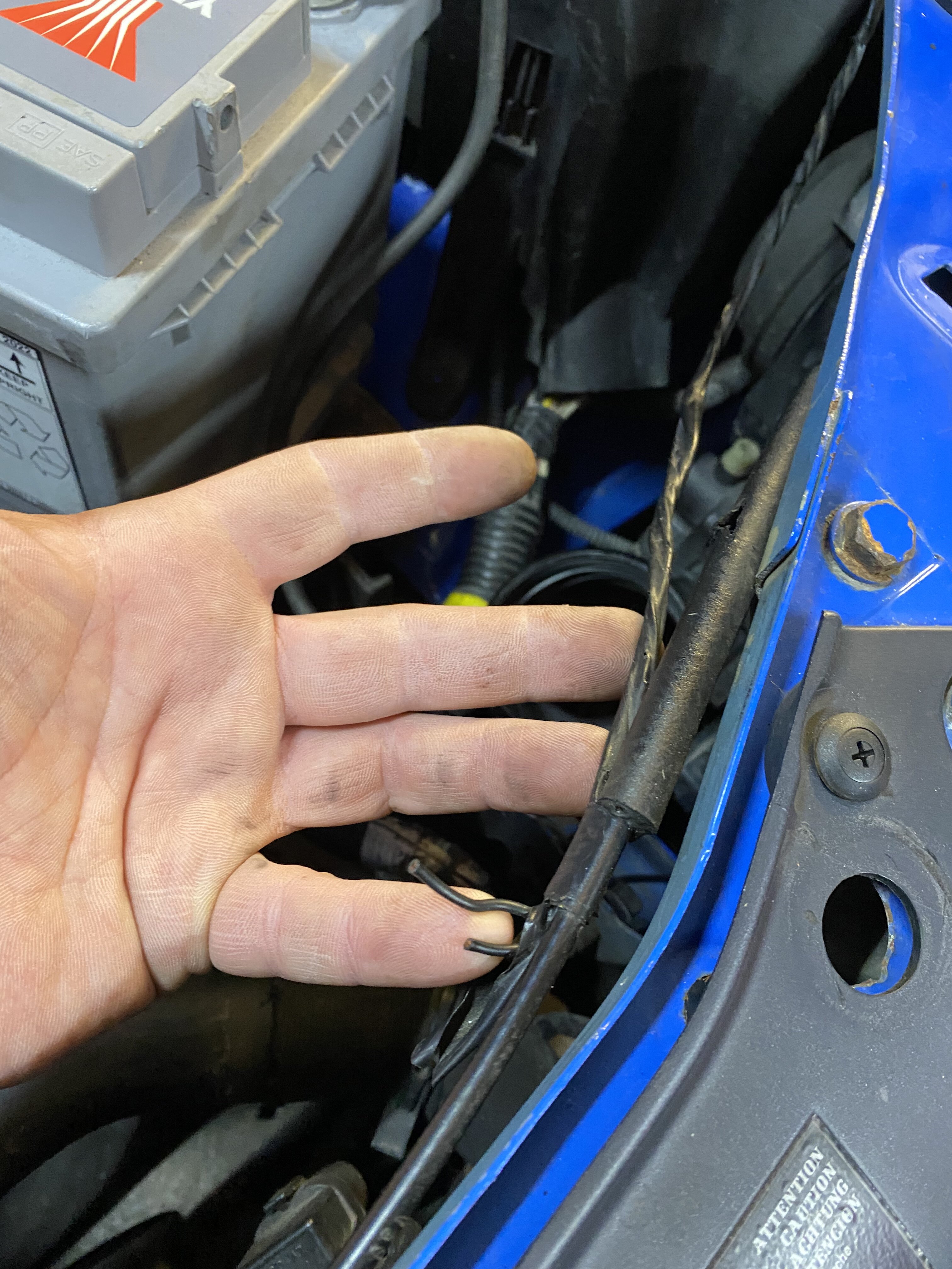

J jody391 ClioSport Club Member clio 182 Apr 8, 2022 #7 Ok whilst you guys are around any ideas what these wires that are connected to the bonnet release cable are that have been cut??
J jody391 ClioSport Club Member clio 182 Apr 8, 2022 #8 These here? Attachments 5E756206-A790-4CAA-9FE8-496A05029973.jpeg 1.6 MB · Views: 60
DaveDreads aka Philomena Cunk aka Barry Shitpeas ClioSport Club Member Golf PD130, 172 Apr 8, 2022 #9 I know vey little about car electrics, does your car think the bonnets open when it's closed?
J jody391 ClioSport Club Member clio 182 Apr 8, 2022 #10 No I have no lights. I can’t however see any bonnet switches? Should there be one and where? That could be it then.
hopgop1 ClioSport Club Member RB 182 Apr 8, 2022 #11 Looks like bonnet switch wiring to me, would go where that hole in your grill in the above photo is.
Robbie Corbett ClioSport Club Member 182, E46 M3, 1000RR Apr 8, 2022 #12 They were for the bonnet switch I think. Often people unplug the switch to stop the alarm going off. I used one of these to block the acoustic valve port: Auto Silicone Hoses End Blanking Caps - Finishing Bungs Silicon Pipe Rubber | eBay Open the car will idle poorly.
DaveDreads aka Philomena Cunk aka Barry Shitpeas ClioSport Club Member Golf PD130, 172 Apr 8, 2022 #13 jody391 said: No I have no lights. I can’t however see any bonnet switches? Should there be one and where? That could be it then. Click to expand... Top right hand side of the grill next to the text sticker.
J jody391 ClioSport Club Member clio 182 Apr 8, 2022 #14 Thanks guys mine has gone then. Atleast I now know what it was. 😎
