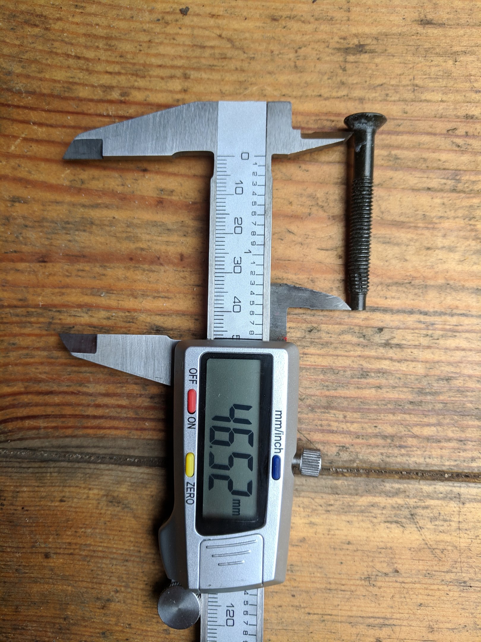

what size bolt in 182 foot rest
JamesBryan
Any joy? ?
These any good?

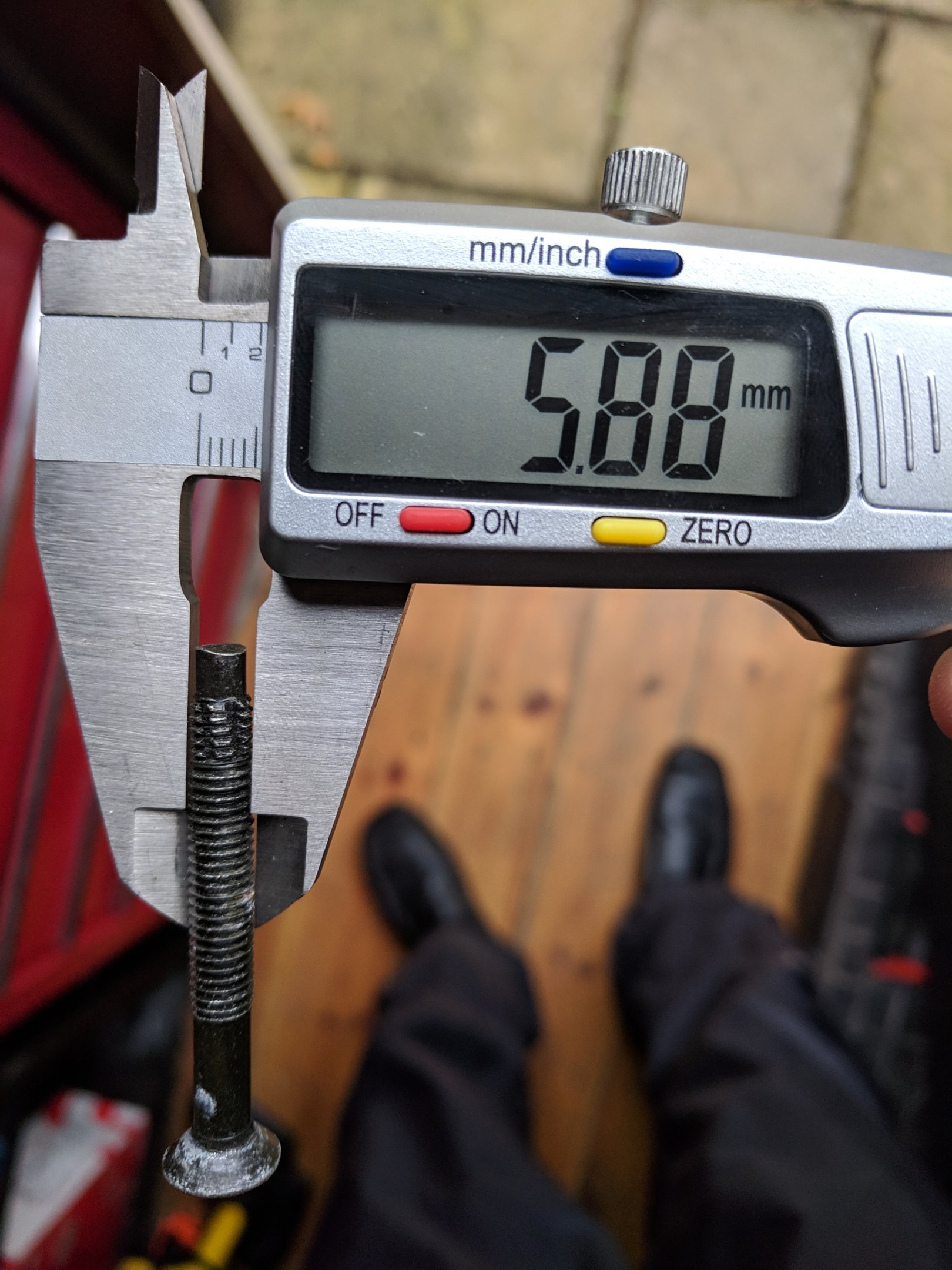

I'd say it was an M6 thread.
Andy_con
  clio 182
God knows why it's so long even though it's only partially threaded.
The head on it was a T27/30 torx, but Allen head would be just as good.
Oh yes your right it's not Allen is it.
That's cool I should be able to get a full dim drawing now I know the size

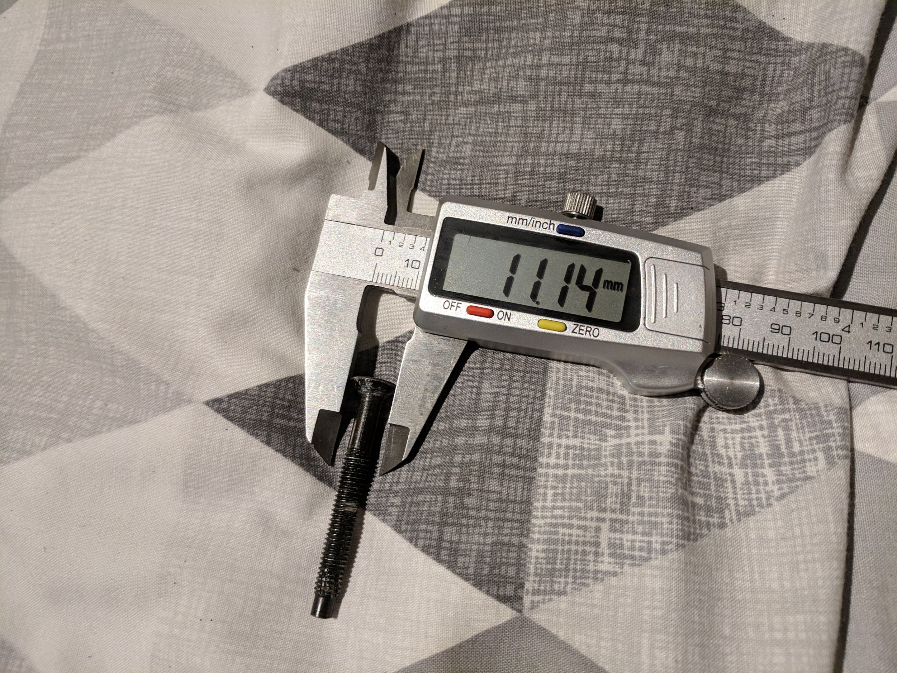

to be a real pain, you didn't get the width of the head did you?
a few variations between 12mm and 12.7mm
