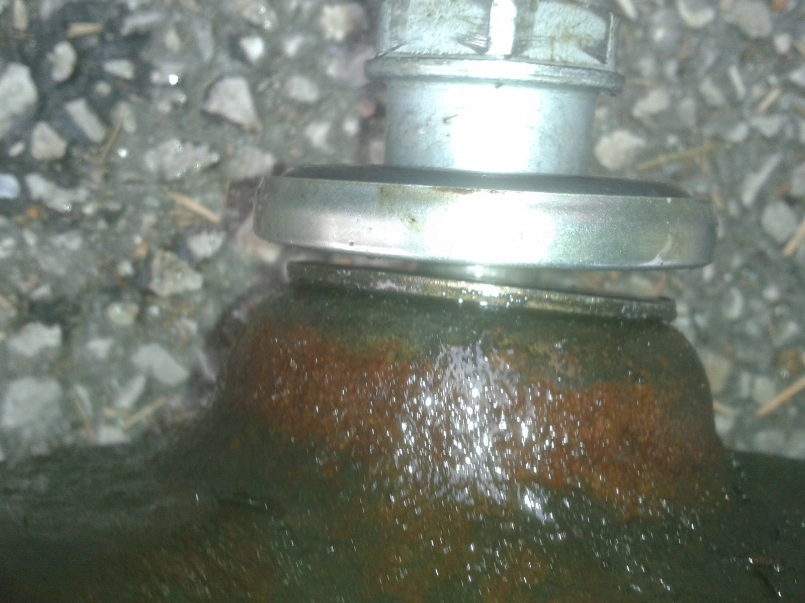

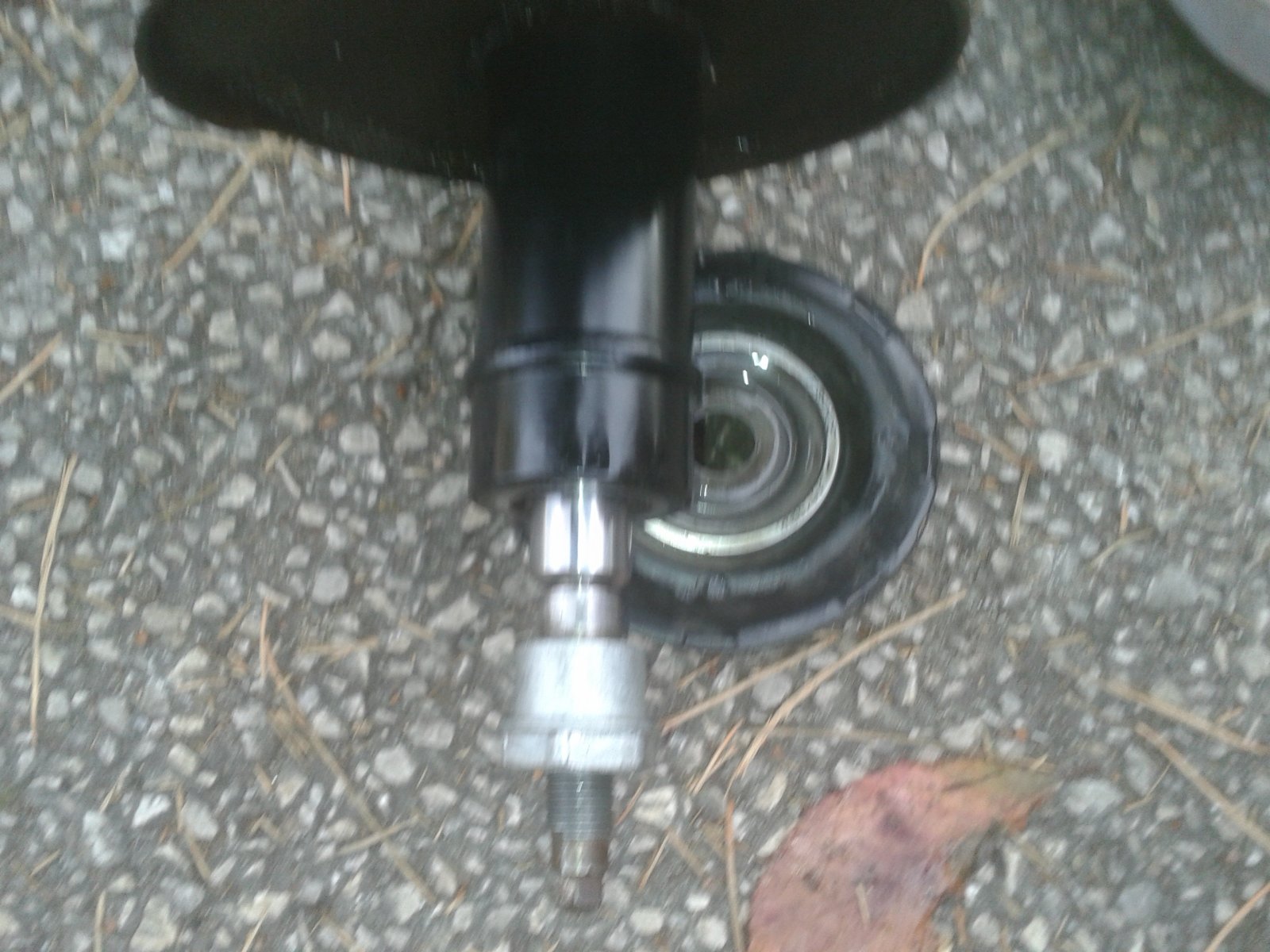

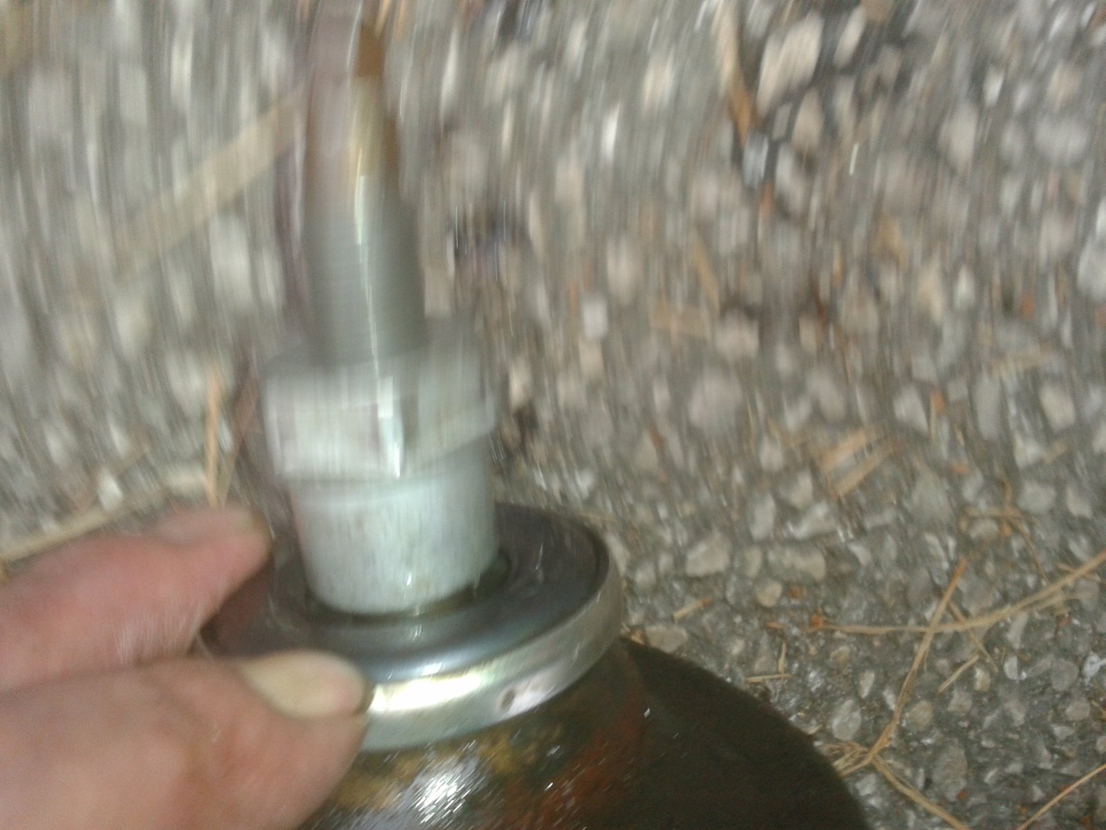

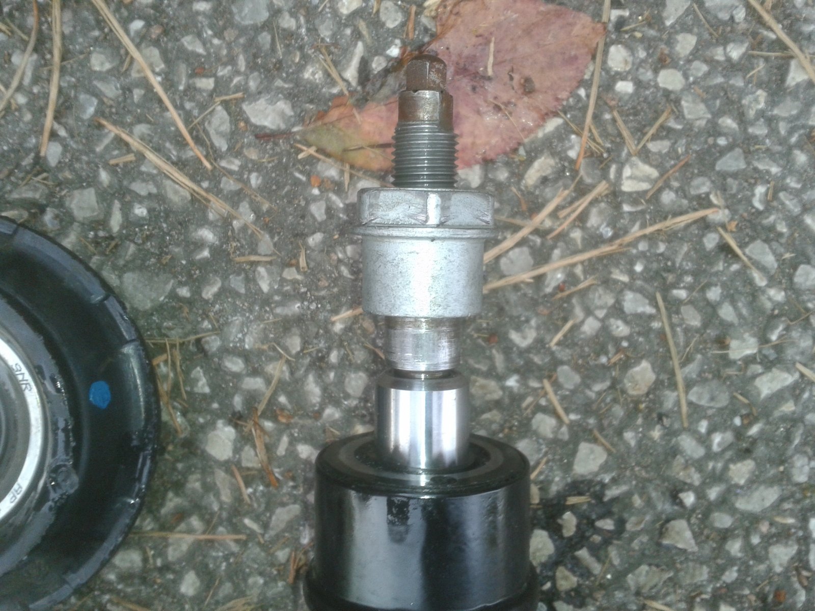

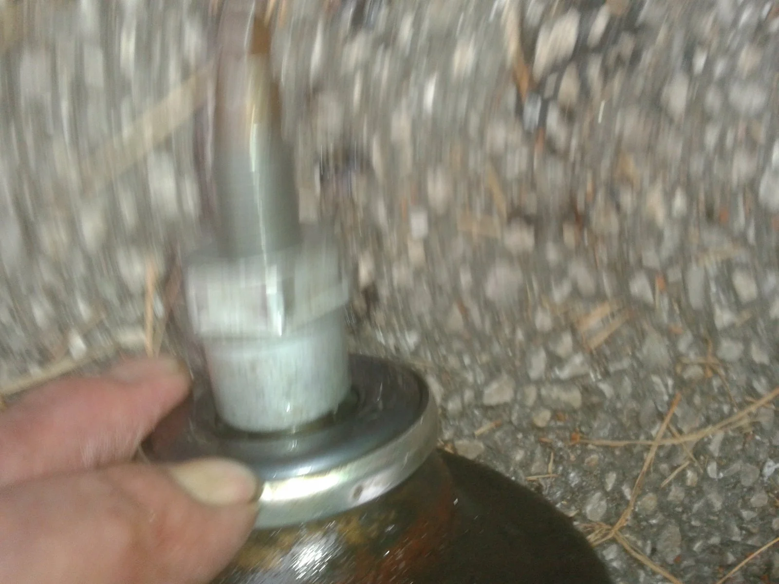

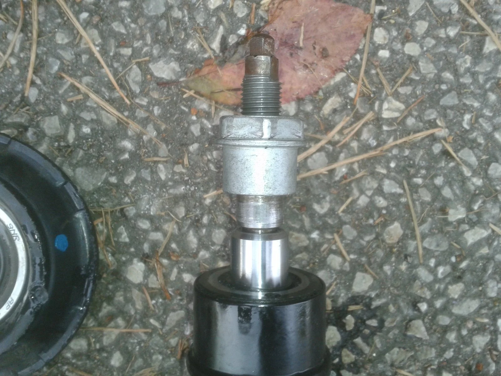

As title, what size socket will I need for new spacer?
27mm,but check it touches down on the bearing before it becomes thread locked.You may have to remove threads to use it.
Why is that? I bought it as part of a top mount kit from Renault so I'd expect it to fit perfect.
No idea, it's been like it for three years now and they still haven't changed it. Unsure if it fits something lower spec but never tried Sports, no idea
Seems like some have no problems after fitting new mounts and inserts. I have OEM Cup shocks and springs so will give you an update when fitted.
Still got all old mount parts so will do what's been suggested if new insert doesn't fit correct.
It's only the bearing and rubber that wear out, use the old parts that don't wear and then it'll be fine next time
New top mounts and spacers fitted today with no issues. All nice and tight and new top hats sit perfect.
