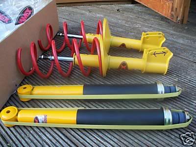

Hi i have a 1997 mk1 clio 1.4 maxim and i am just wondering what i need to measure on my original strut because there are two different sizes?
Thanks.
Need to measure the spacing (Centre to centre) of the two bolts which connect the hub to the strut, Will either be 52 or 54mm.
Its easier to just measure top of one bolt to top of the other bolt though.
So do i measure the two bolts at the bottom of the strut that connects it to the hub?
Here where the arrows are?
