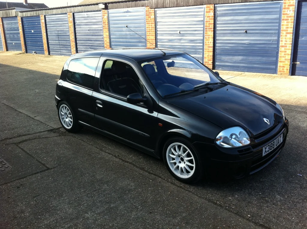

  182 Turbo
really.....
Well kinda, I mean obviously it has an intercooler and the wastegate noise (don't have a DV) it doesn't look anything special,
And wag I know exactly what you mean about the clutch, I've got a helix 4 paddle and it's a ***** lol, although I have absolutely no problem driving it now, just like anything u get used to it, I've even perfected holding the car on an incline with the clutch, which is fking hard lol!
Mind you, I jumped in my mums 1.2 clio the other day and found myself pulling away at 5000rpm rofl, can't drive normal cars now!!
