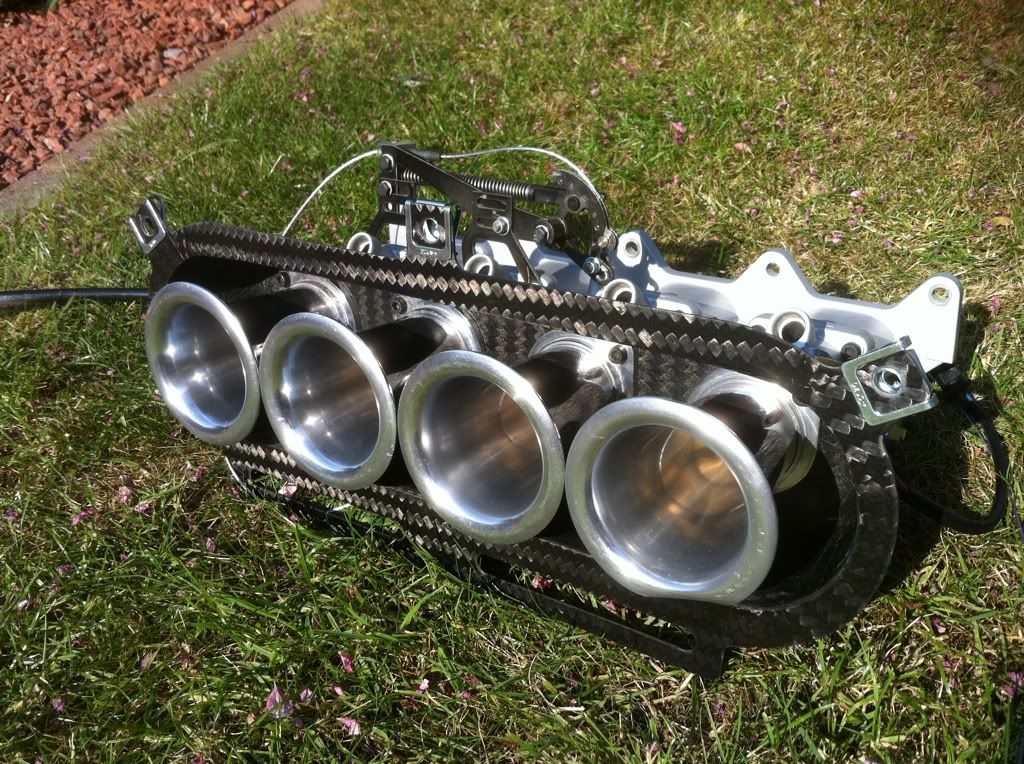

Where did you get the carbon backing piece for your air filter from , I need one for my golf as it has a flat alloy one on and the filters are tight up against the trumpets
there's deeper filters available too. As you already have the flat backplate in place.

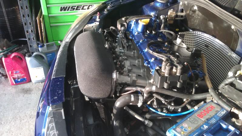

This is mine with a flat backplate and 90mm trumpets
With a dished backplate You could get 120's under there. What filter do you run?
