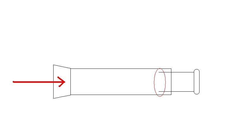

like Ben says, its shite (sorry to be blunt!) the internal bore is terrible
This is what i saw of the blueflame item and why it costs circa £30 trade.
Flow enters a 2.8" bore, tapers down to 2.5".....which is all fine and dandy until you reach the cleverly designed reduction to 1.9" where it is rolled to meet the stock type exhaust flange. To make matters worse, the 2.5" - 1.9" change happens with a blunt face direct open tube sectional area change (circled)......fantastic.
Interesting ...... do we know if this is the finished design?

maybe someone with a blue flame decat would care to comment or show pics?
But i dont see how far 'design' will go for a tube.
I've got mine being delivered tomorrow so will take some pics.
If it is the case that the bore tapers down to 1.9" then it will be going back.
