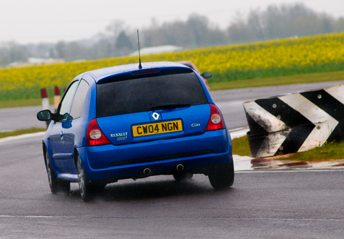

Hey guys, i've had my clio just over a month now and i'm going to have about 1k to spend on it at the beginning of June.
Here's the car as it stands today...
Track pic FTW!
