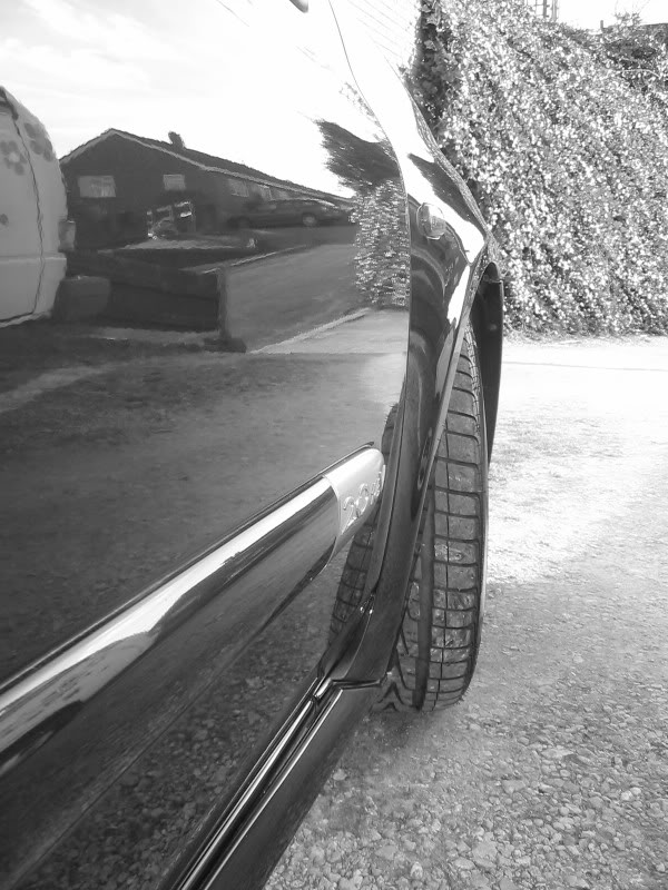

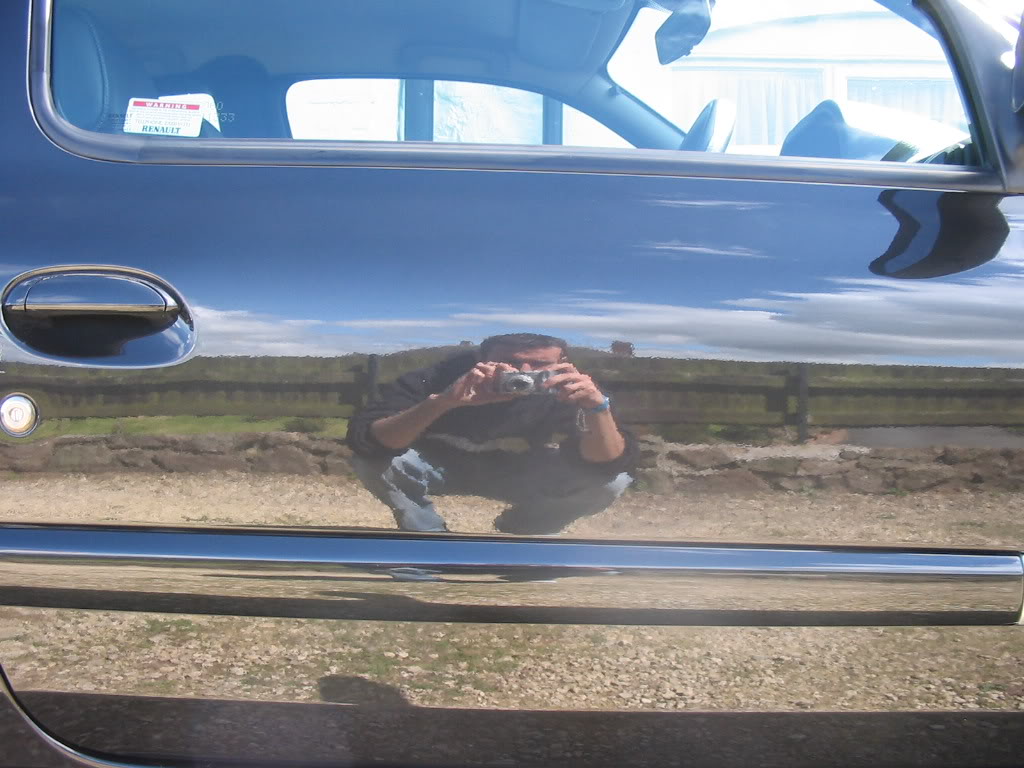

I did mine at the weekend and used:
Meguiars Gold Class Shampoo to wash
Dried with microfibre towel
1 x coat of meguiars paint cleanser (step 1 from meguiars 3step system)
1 x coat of autoglym srp
2 x coat of megiuars carnauba wax (step 3), coats applied 24hours appart.
Came up a treat!
Not bad for stuff from halfrauds! lol
