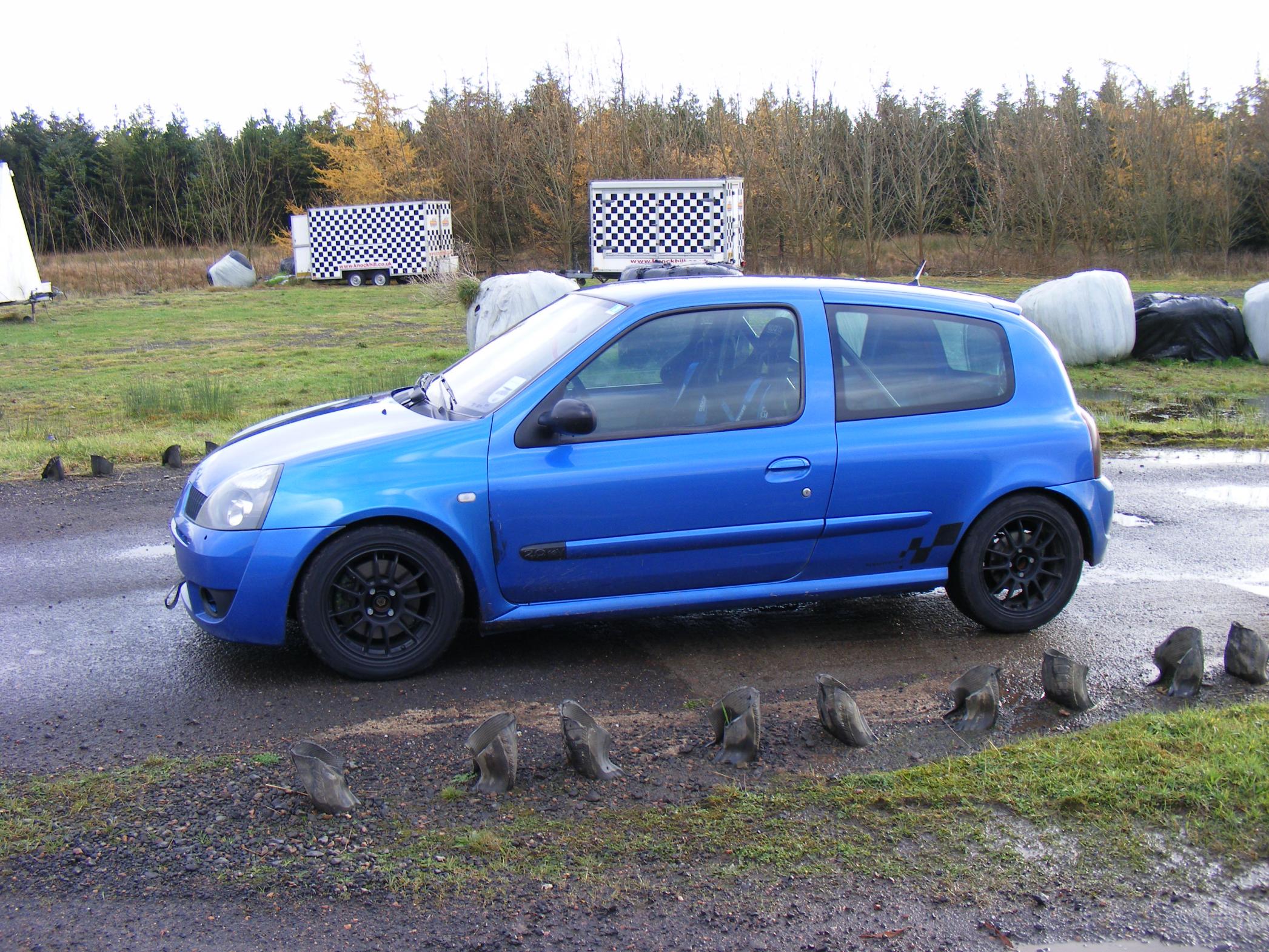

  clio 182
this is my one on oz's. very light and look spot on in my opinion!
they are 15's and its a 182, bought for 200 second hand. hope that helps.
you do know 2118s are VERY heavy and i dont think there will be any weight saving, they are very strong and look great though.
