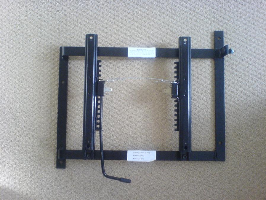

This is what i have. You buy the runners separetly but tbh you dont really need them. Find the position you want an then bolt it in!

I'm gonna say yes but they may have to be modified slightly.
They have quite a few different holes on so hopefully one of the sets should fit Sparco side mounts but i cant confirm that.
You could always drill the holes that you need though.
