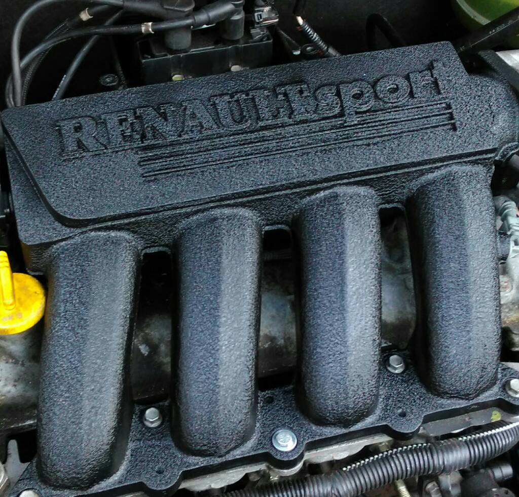

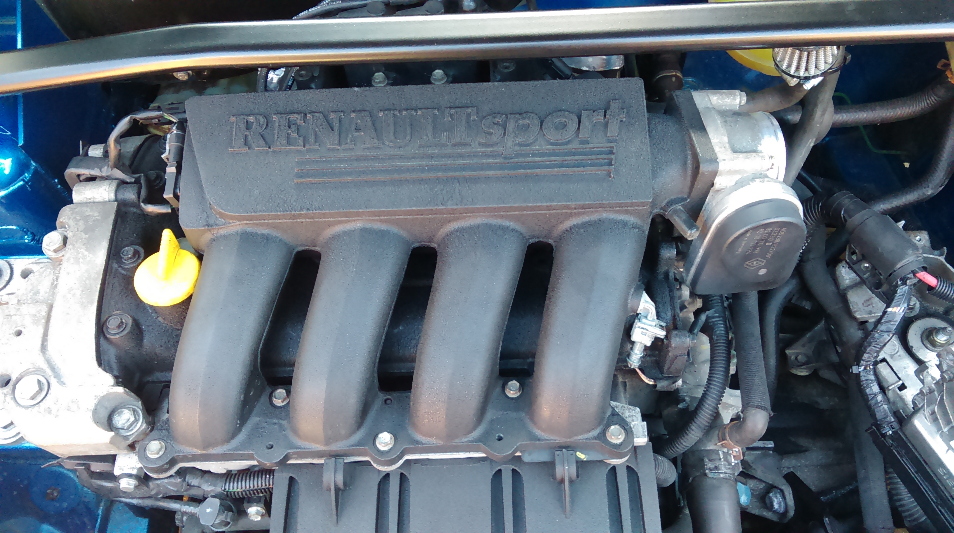

I did my inlet manifold yesterday and it came out perfect like this

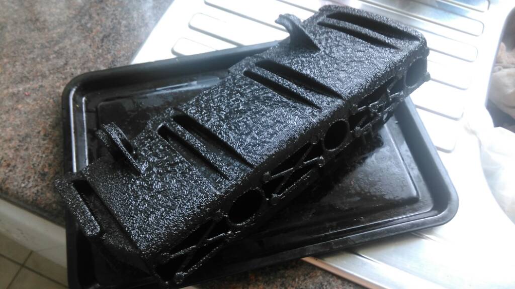

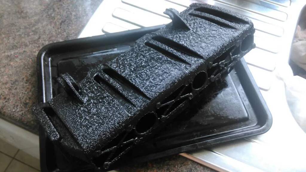

So to day I cracked on and did my fuel rail guard unfortunately it's come out all glossy and no where near as finally wrinkled as the manifold.
What's gone wrong? Not enough paint? I used the same tin for both do it can't be a difference in batch

The top bit looks pukka... The lower might have had more contamination, strip clean, wash, degrease and leave to bake in the sun before trying again..
I've painted a few sets of wheels and leaving them to cook in the sun really helps after wet and drying, cleaning etc.
  172
Cheers mate. Time to get some paint stripper and start again. I'll leave it overnight and see if it cures a bit more. The inlet manifold cured within 5hrs like that so I'm not hopeful as the guard has already had that time but hey ho

When i did mine i baked my inlet in the oven came out well just smelt so bad and to achieve a similar crinkle on the fuel rail cover i baked it unpainted then sprayed it straight out the oven
came out fine on mine.
