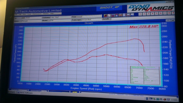

Thats because you didnt have it mapped correctly, 99% of turbo fwd cars are utter utter rubbish on track and most people havent ever experienced one done properly, but it doesnt have to be that way.
Here is the torque delivery of mine at half throttle for example:

Yes Chip, yours is very good, I can vouch for that.
Thanks mate
