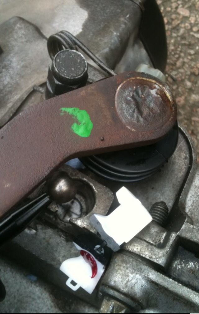

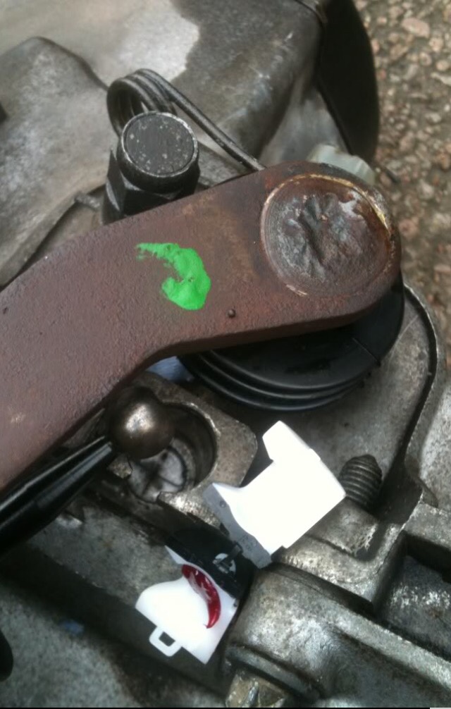

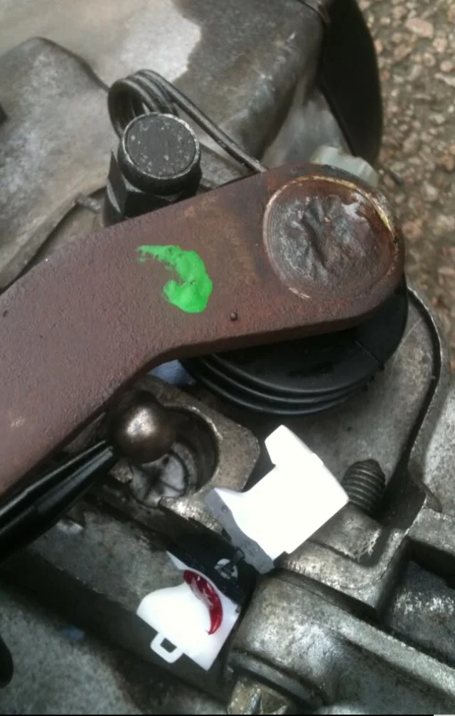

The bush is for the shifter pin that's at the gearbox mate. I'll try and dig a part number out.

Done mine recently and need to take it off again to bend it slightly. As above its a bit fiddly, wouldn't be paying someone to do it though as its only 4 bolts under the heatsheild, I did however have to undo my scorpion decat as well as there wasn't enough room to get the thing in and out.
