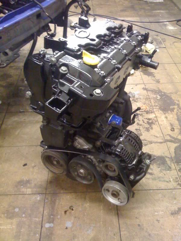

this pipe, it goes from the inlet manifold into the car!
just wondering what it does!
  850 T5. mmmm Turbo!
Next question.
whats the bit do which is slightly more raised than the rocker cover.
all the bolts in mine dont have heads on and it leaks oil!
I recognise that engine :)
It's the oil strainer/breather. Worth noting your one will be different as my new lump (above) has an 830 strainer on it.

well yours sits alot prouder than mine.
but i still have something similar and it leaks.

The pipe looks like the crankcase breather to me
Ohh just realised you can enlargen the image, Ok maybe thats where the servo vac goes been a while since i worked on theses engines!
