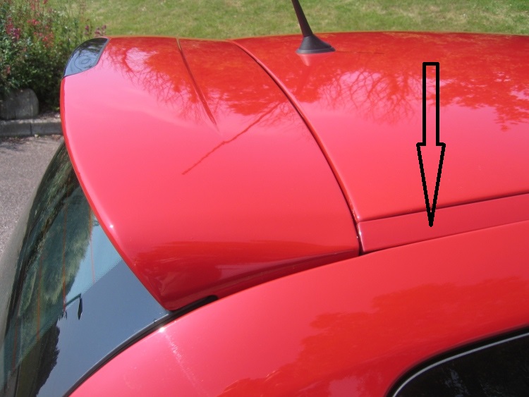

What's this panel called and is it removable?
  FF 182
This one above rear passenger windows? The paint on mine is bubbling in places, looks crap and would like to sort it out.

I think they slide backwards then lift off, maybe easier with the boot open. Sure someone will confirm.
loggyboy
Mine came off no problems, carefuly lever (old plastic ruler or a 'pry bone tool') on one side all they way along, rather than lifting one then pulling from one end then. They have little plastic clips that are very brittle so best to do it during summer when the clips and the bar is more flexible!

They are metal I bent my set getting them off as I too thought they were plastic! I had to get another set from Renparts and then have them sprayed.
They slide back a little then you have to ease them up without lifting the strip too high as it will crease. The plastic clips often get left on the car so pop them off and fit them to the strip first before refitting it. You also have to align the white clips with the pins on the roof before trying to clip it on.

Could of sworn the ones on mine are plastic. As i said in the op, the paint is bubbling, in 3 places, but no sign of rust, so maybe i just assumed they were plastic ^^
