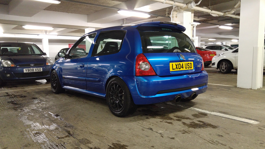

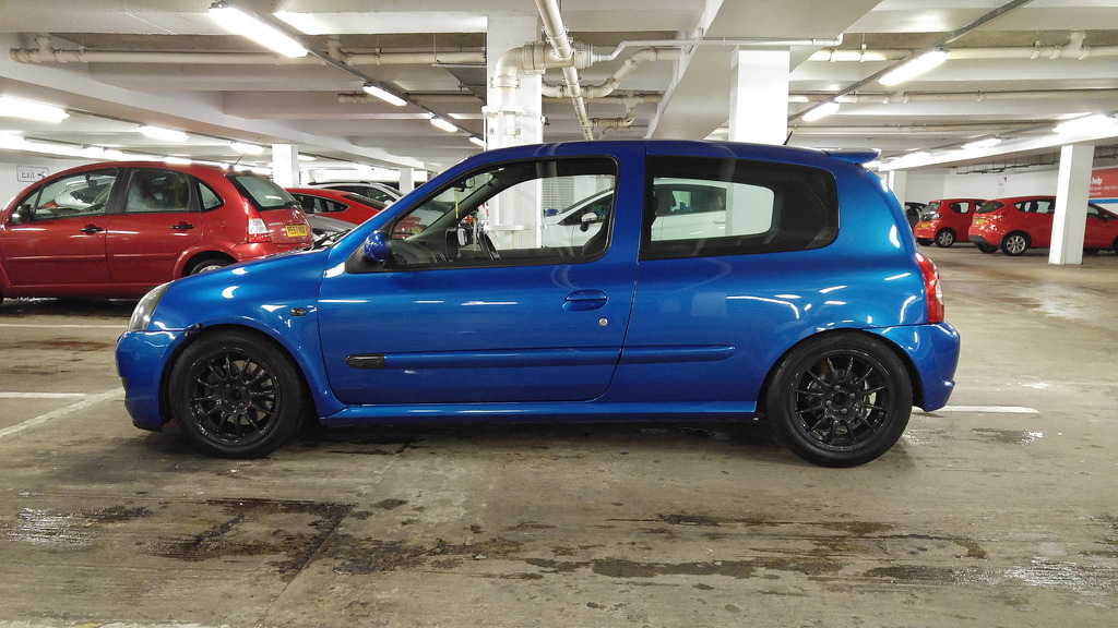

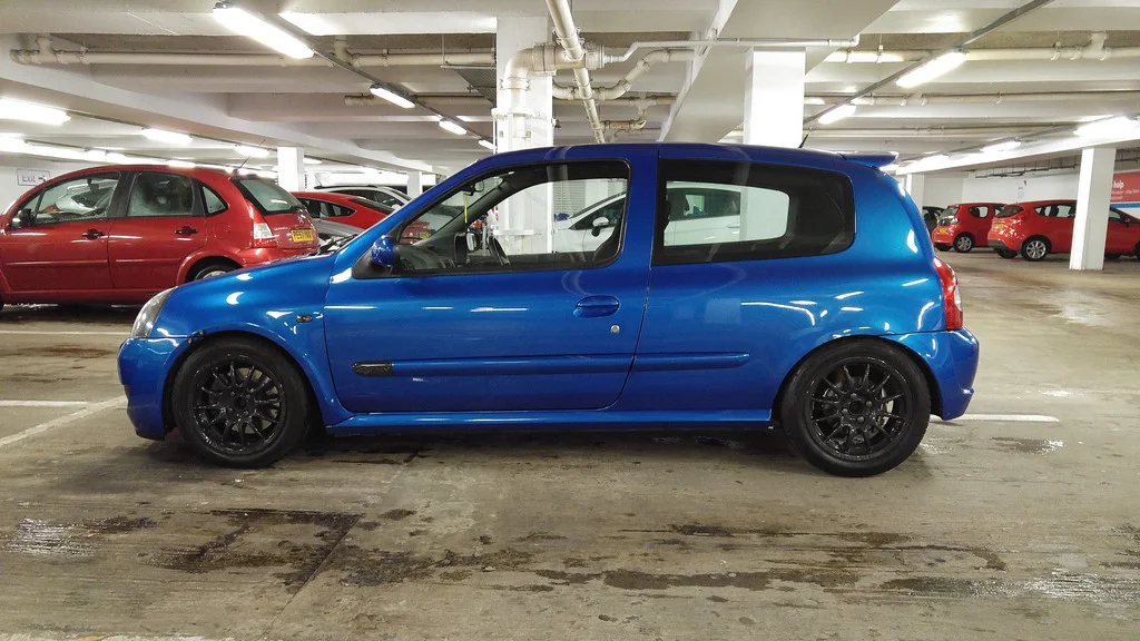

Good choice! I have the same. 20mm up front and 10mm on the rear and this is how mine sits
20151220_140118 by dann2707, on Flickr
20151128_155330 by dann2707, on Flickr
20151128_155100 by dann2707, on Flickr
