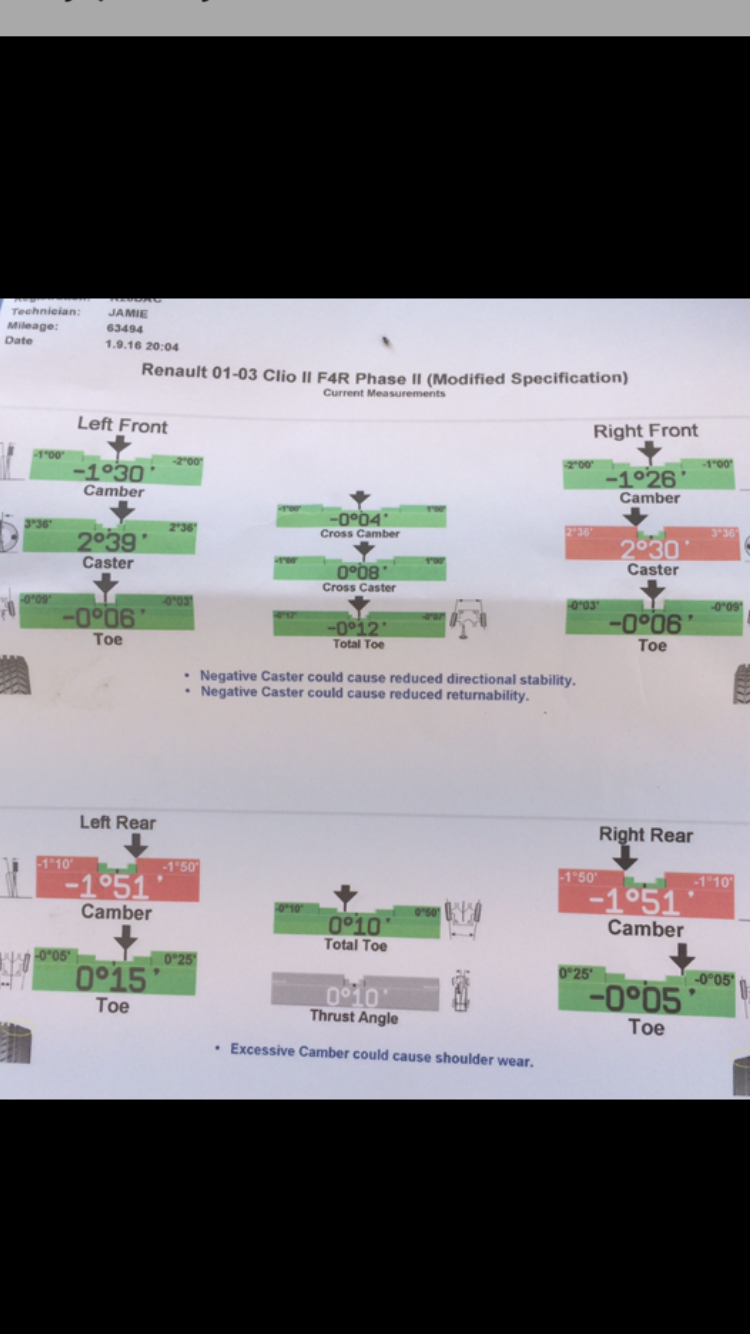

I’m having an mot done on Wednesday and thought whilst it’s there they could get the wheel alignment done.
The car was lowered on H&R springs a few weeks ago and have cup shocks.
What is the best set up for me?
Thanks in advance

This works for me, road use.
