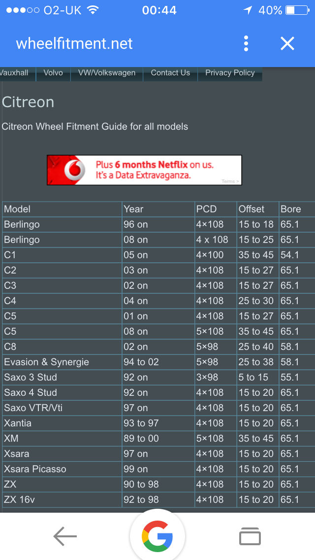

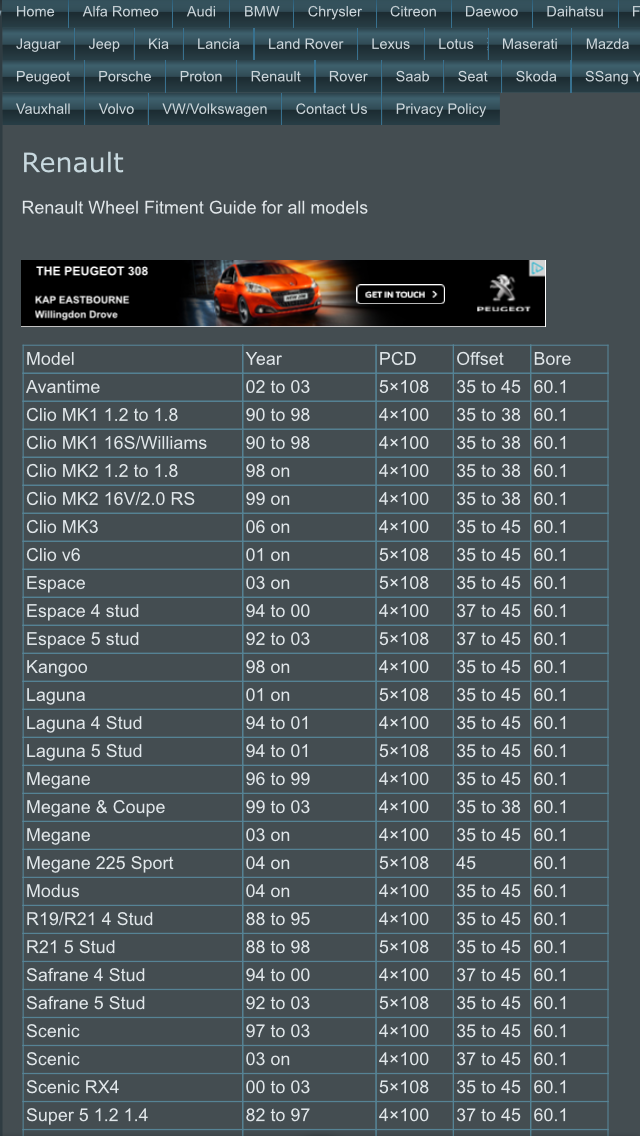

Girlfriends got pro race 3s on her Citroen c2 vts. I want them! Will they fit my 182? Going by the wheel fitment guide online they won't... Am I right? Please see attached cheers!

You'd need adapters and maybe a set of spigot rings. A good quality set of adapters can cost over £190. Personally I'd say there are better wheels that can be made with the correct fitment
