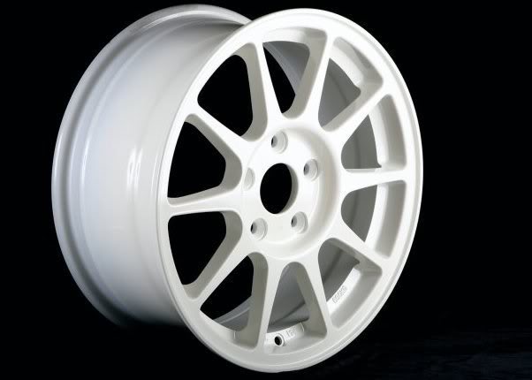

I think the wheels off this would look good on a 182, what are people's opinions?

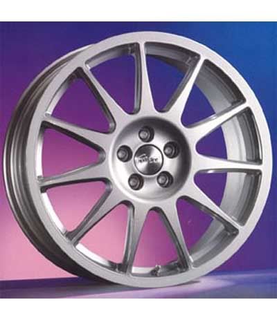

Look quite similar to turinis.

if you want a set of turini's in anthracite, you only have to ask. ;)
Hmmmm, that's tempting!! You bored of yours then?
It pro's and cons though!
The dc2 wheels are 6.45kg, the turini's 8.something!
The turini's fit perfectly, the dc2's would need spigot rings!
I'm undecided!
DC2s are also 5 spoke not 4 spoke so you'd need hub adaptors. Not sure on the offset nof the DC2 but thats probably out to so spacers maybe? By the time you got them to fit you'll have added all the saved weight back on.
They can be had in four stud if you know where to look, in the right offset. Not Honda originals though.
