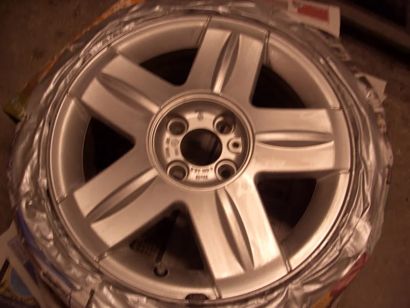

So I removed the kerbing from the two that had some damage with some very rough paper and then gradually worked the marks out with finer grits. Then sanded the whole lot down with an 800 grit, again a time consuming process, but I hope it’ll be worth it. Finally I used gaffa tape and some news paper to cover the tyres.

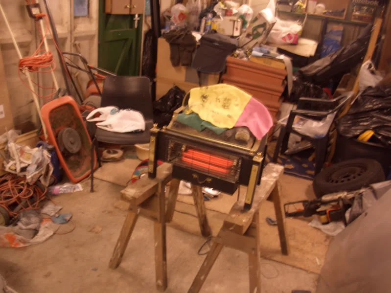

Then I set up my super awesome, expensive, dryer. (yes it’s an old electric fire)

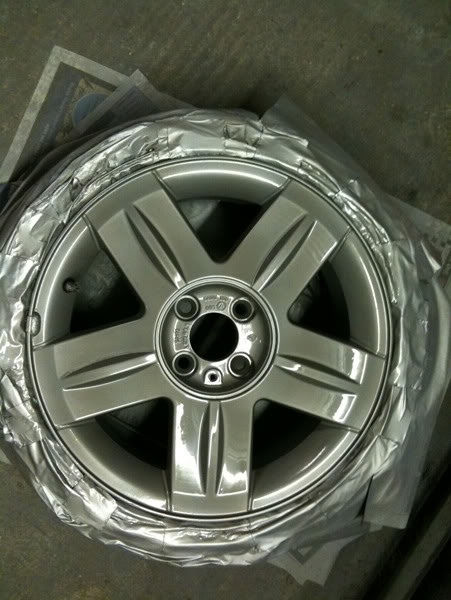

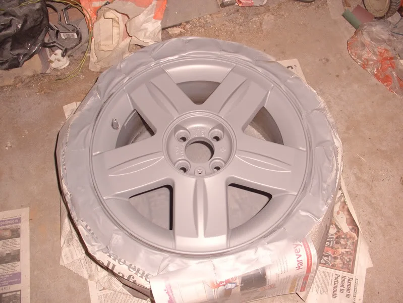

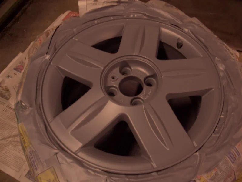

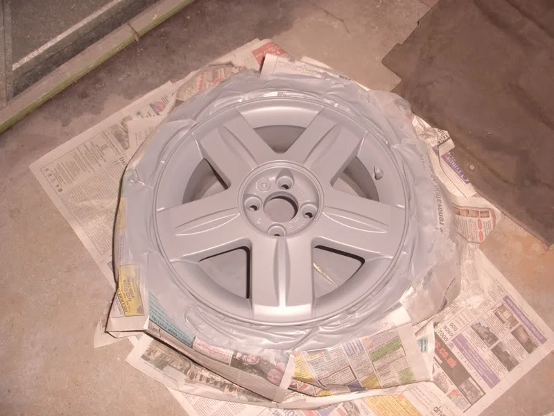

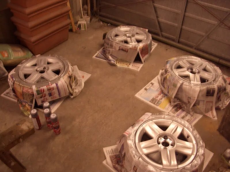

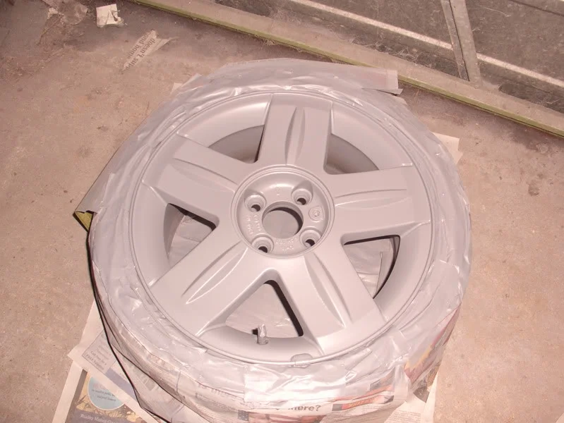

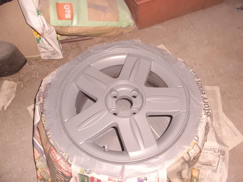

I primed up all 4 wheels, but one of them for some reason had some bad bubbling, and where the lacquer underneath was awful it gave a bad result. I also totally forgot to do the centre caps… doh!

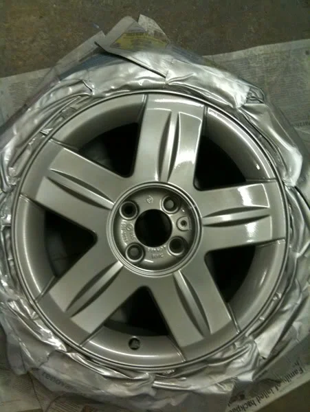

Fine one

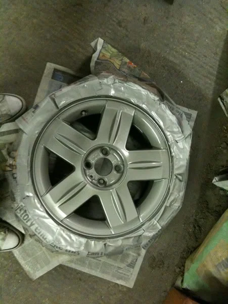

Bad one
Unfortunately this set me back a day, So I rubbed the bad wheel back and checked the other for any imperfections, and then re-sprayed the bad one. All four were now good….

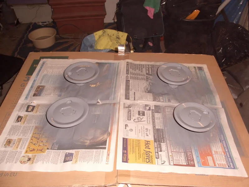

Whilst I was at it I decided to rub down and prime up the centre caps

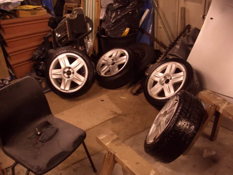

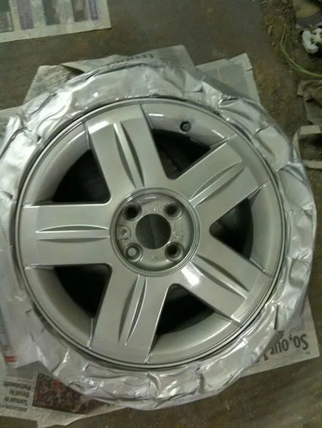

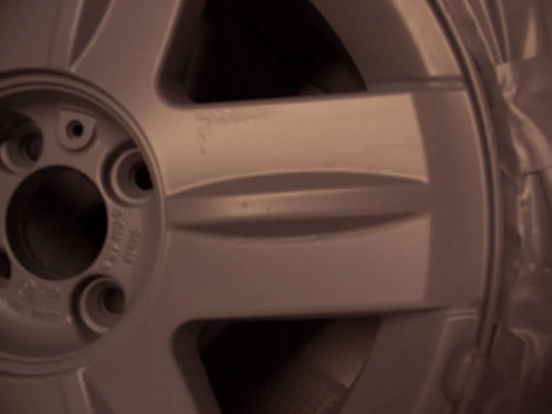

Now the wheels look like this:
I wish I had taken pictures before as they were a serious amount lighter than this, and the lacquer has made them VERY dark. Fortunately I’m quite keen on the colour anyways, but I do wish they were the initial colour of the paint. (A lovely, VERY bright silver)

Cheers, I've just been speaking to a friend who is convinced that if I sand the lacquer back with some 2000 grit and then really polish them up I should get a brighter colour and a nice shine!?
Is he nuts?

Nice job mate! Looks good and takes a hell of a lot of patience. Your mate is right, start with 2000 grit, then finish with 2500 grit (Wet-sand). This will give a glass like finish to the laquer and bring the alloy nearer to the colour of the silver you originaly applied. Finaly buff with a polishing compound. Takes more time but if done correct should look perfect;)

Cheers for the advise, any suggestion on what polishing compound to use? Or an example of one at least so I pick up the right thing?
  clio 172 phase 2
Just go to Halfords mate and you will find what u need there.. Any make will do just make sure its not a harsh one. Hope all goes well, as said before u have done a great job, and if done right u will have the colour alloy's u desire.
