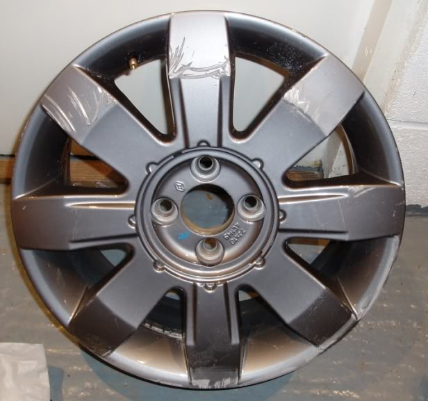

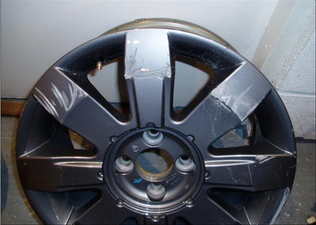

Heres how i did mine . But mine was badly scratched so needed some filler as well . If you do a search there are a few other people who have done theirs so you'll get a few ideas .
Why are you taking the paint off ? Here's one i refurbed .

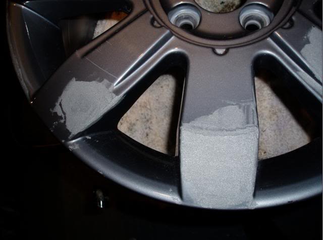

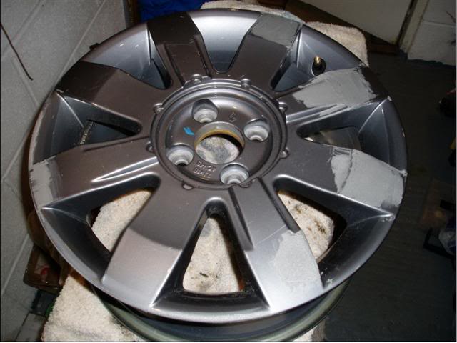

I cleaned the wheel with AG engine and machine cleaner then dried it . Filled all the deep scratches with Upol D Metallic Filler , left overnight to harden sanded it down with 320 grit wet and dry . This also gives the primer a good key as the 320 grit isn't too fine .

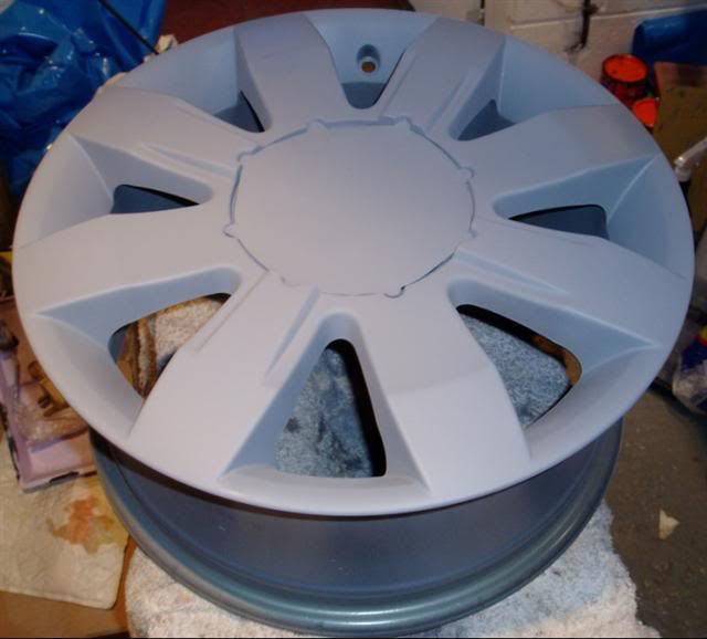

Next i primed the wheel , a couple of coats and used 320 grit wet and dry again .
Wash down the wheel to remove any dust or use a tac cloth .
