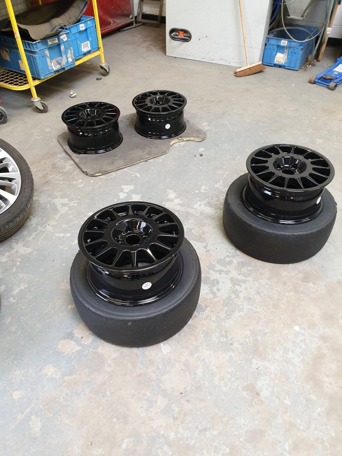

I have just had mine delivered today at £150 for 4 15inch 2118'S in gloss black powder coated.
