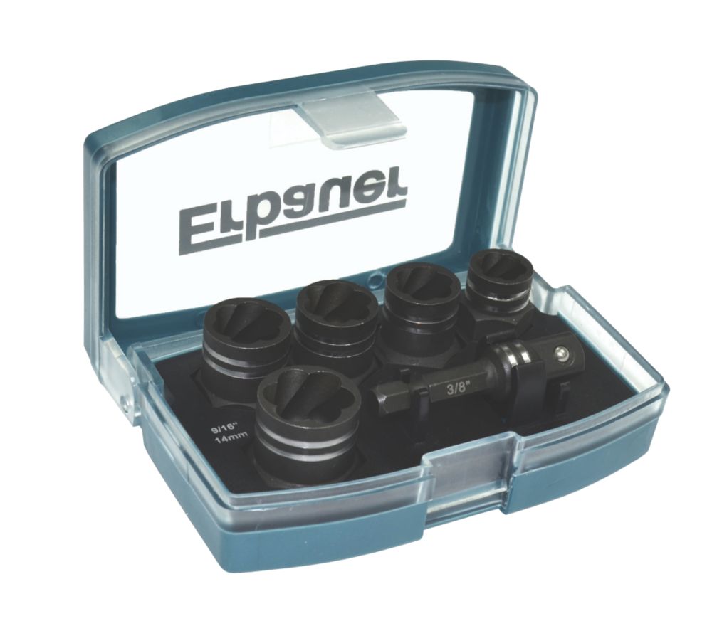

And if they do start to round, get some of these, they're bloody brilliant and got me out of some sticking situations before!

I've got that one it's useless for anything corroded tight I'm afraid.

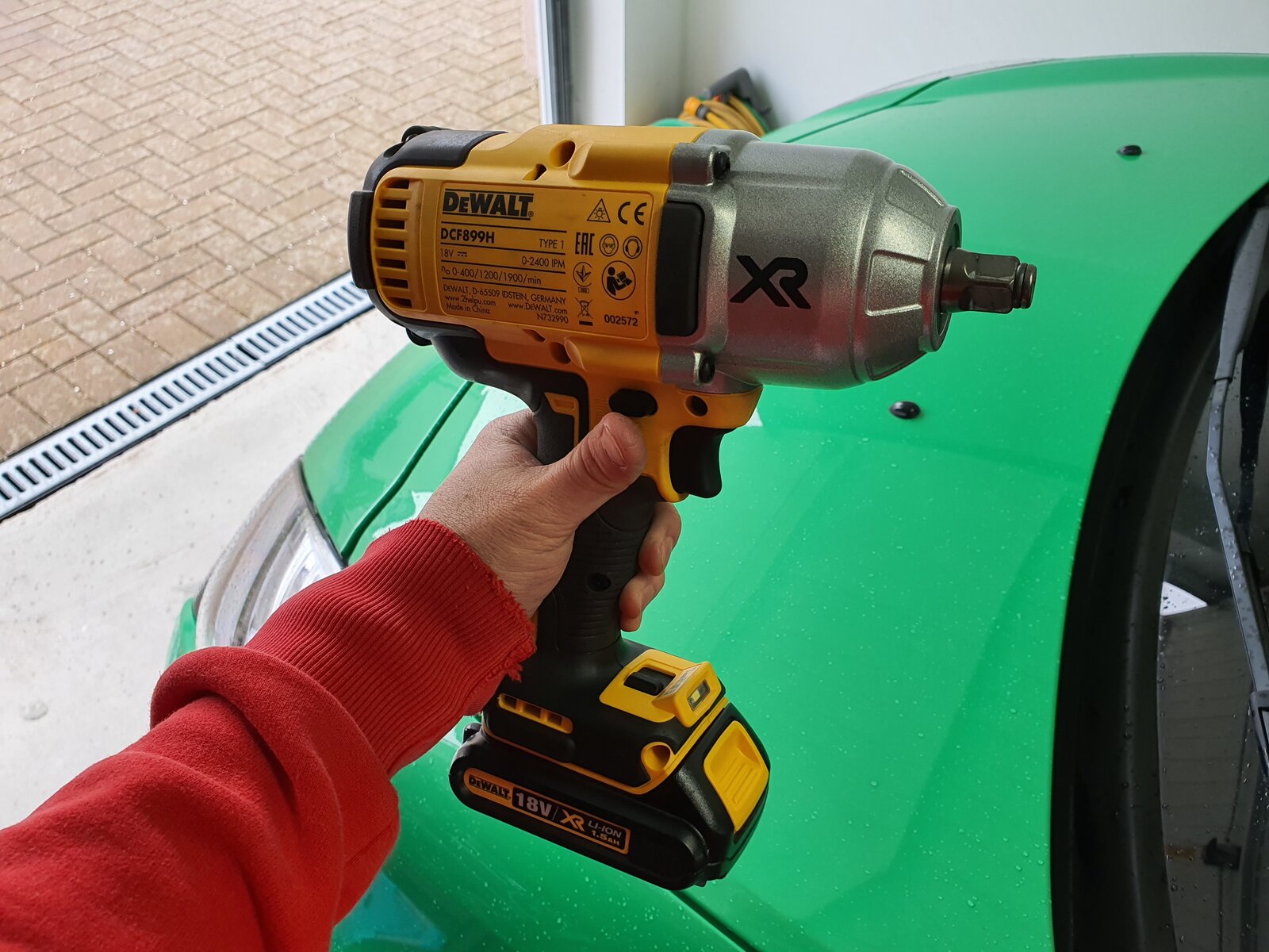

Bigger gun was the solution
