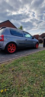

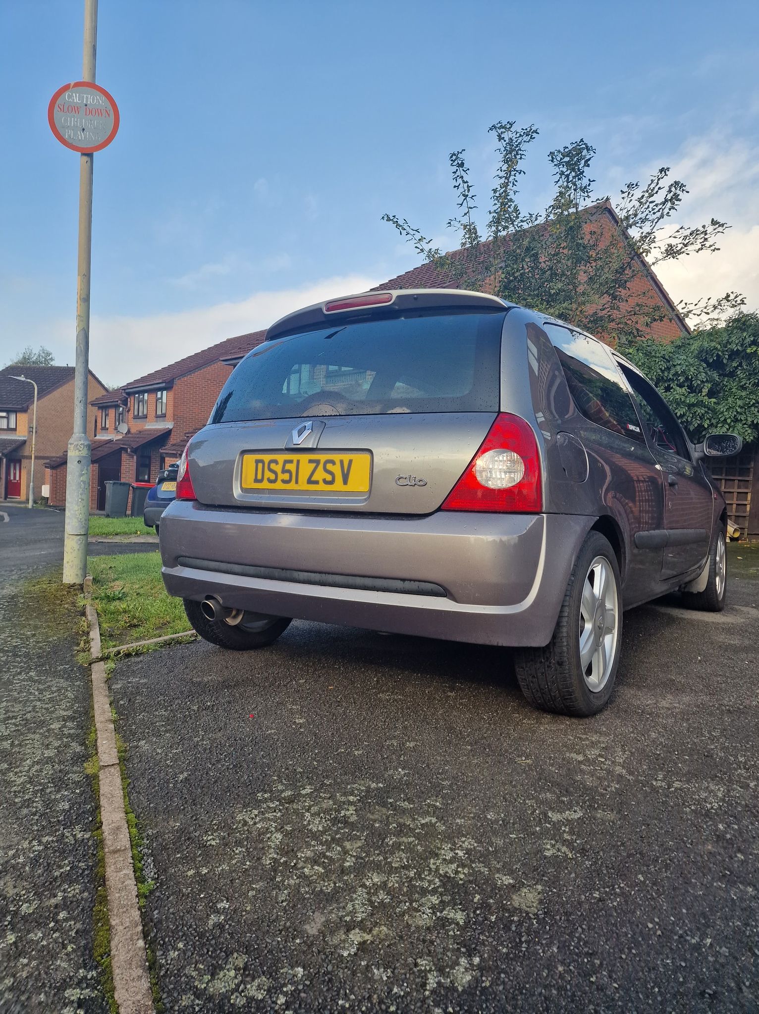

this is how they looked with the spacers on so worth the look until you see the bill for new bearings:ROFLMAO:

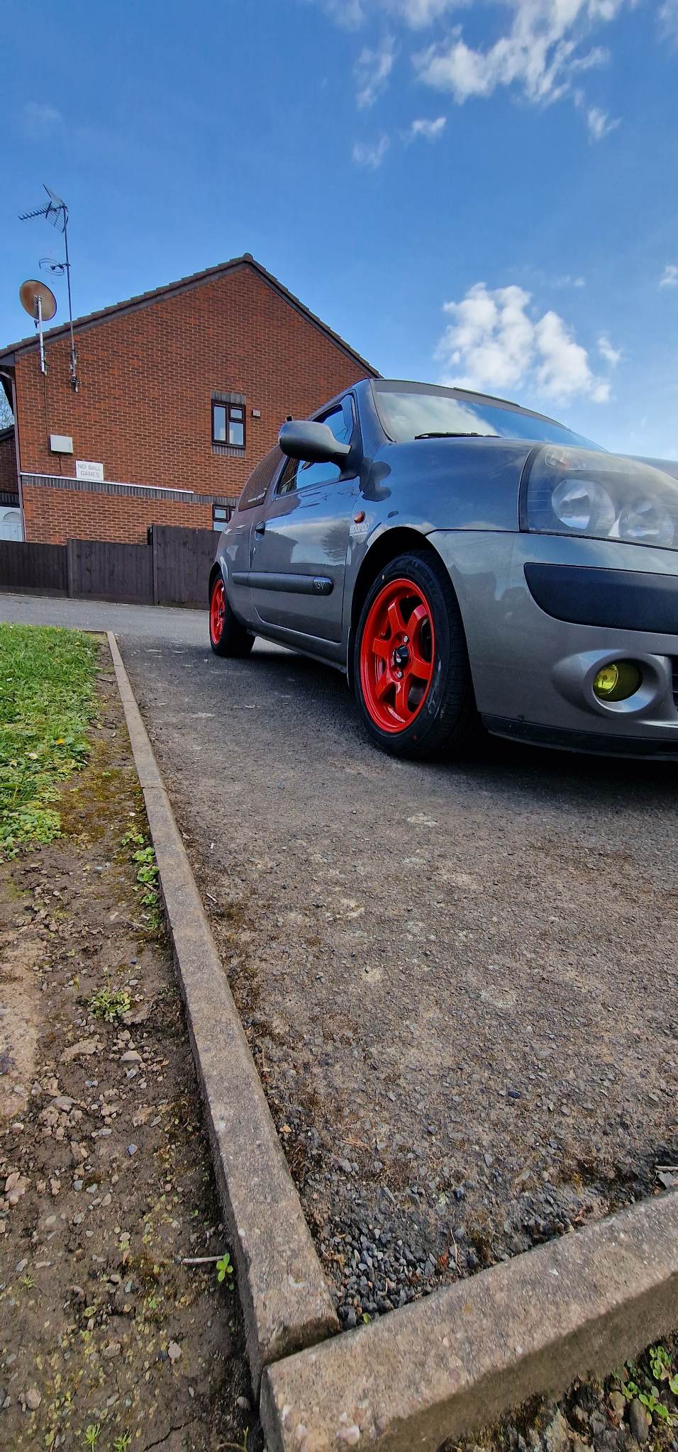

These are how it sits without spacers and with some damn bright wheels!

Yeah it did look pretty good on the spacers, no argument here 👍
So your old wheels were 6in wide and had a 43mm offset, the new wheels are 6.5in wide and have a 40mm offset, so your wheel looks like it's sitting 9mm further out than stock while only actually moving the wheel centre 3mm. If you wanted the same look as you previously had then some 7J ET36 would be perfect👌
Or just slap some decent 10mm slip on spacers on 😂
  1.2 16v Clio Mk2 2dr
Ive just had a double check they are actually 7J my bad:ROFLMAO: its been lowered 40mm as well and had to shave the rear arch liner a smidge but overall with the combination of steering and bearings i think it sits just right. If i had a higher offset with the roads near where i live i might just end up without a liner or a rear quarter:ROFLMAO:
