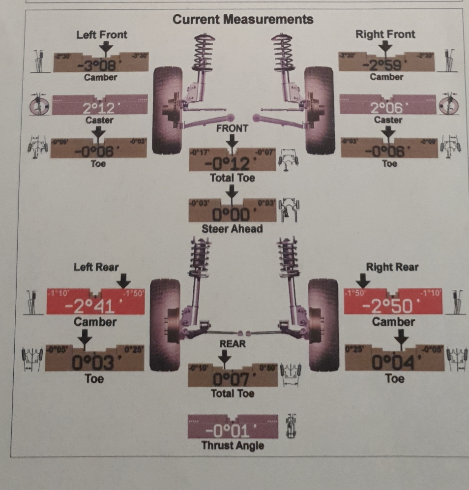

Okay, so I’m wondering if anyone has any thoughts on this. Basically my car has a lot less caster than I expect it should have. I’m lead to believe they should run around 3.10 degrees of static caster from the factory, of which I’ve seen plenty of cars running.
My car currently

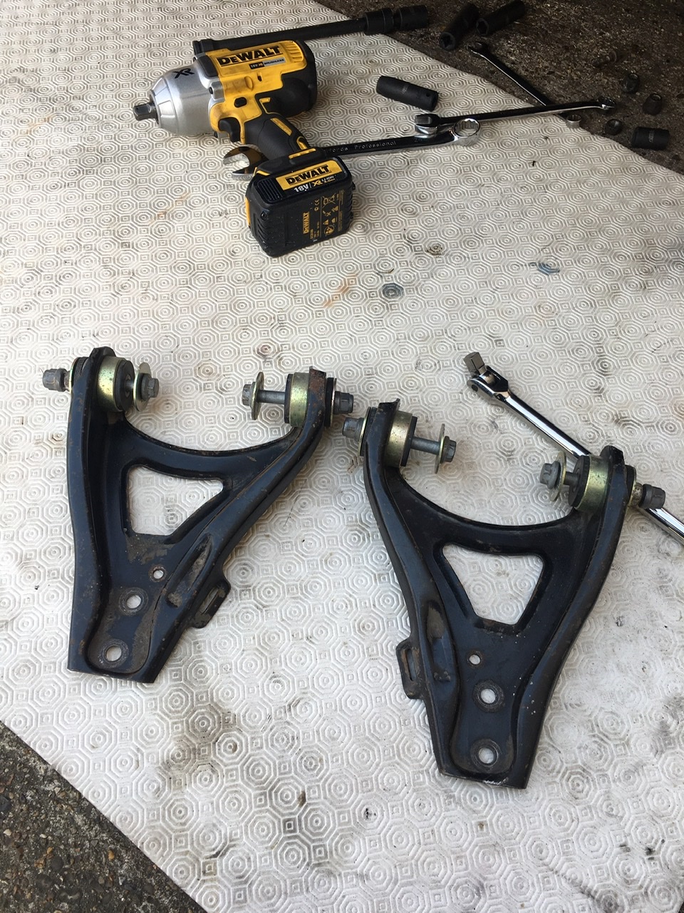

- Clio 2005 FF with both cup packs.
- Correct Cup lower arms
- Powerflex black lower arm bushes
- Roll centre correction hubs
- AST 5100 dampers.
- PMS topmounts.

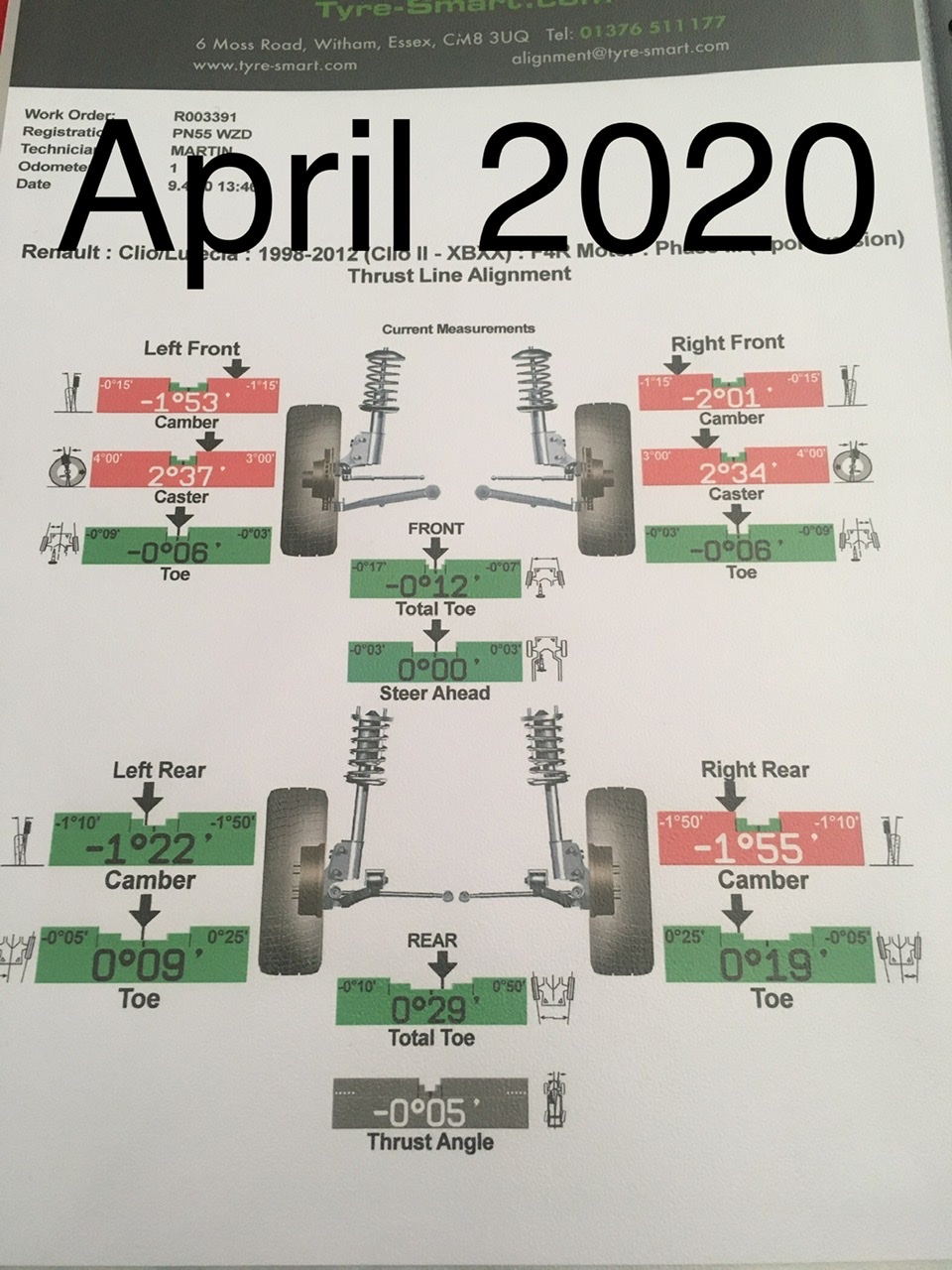

Upon having the geo done you can see I’m sitting around 2.3 area which is pretty low to my mind.
When I fitted the arms I even pushed (for what it’s worth) the uniball carriers as far forward as possible before tightening.

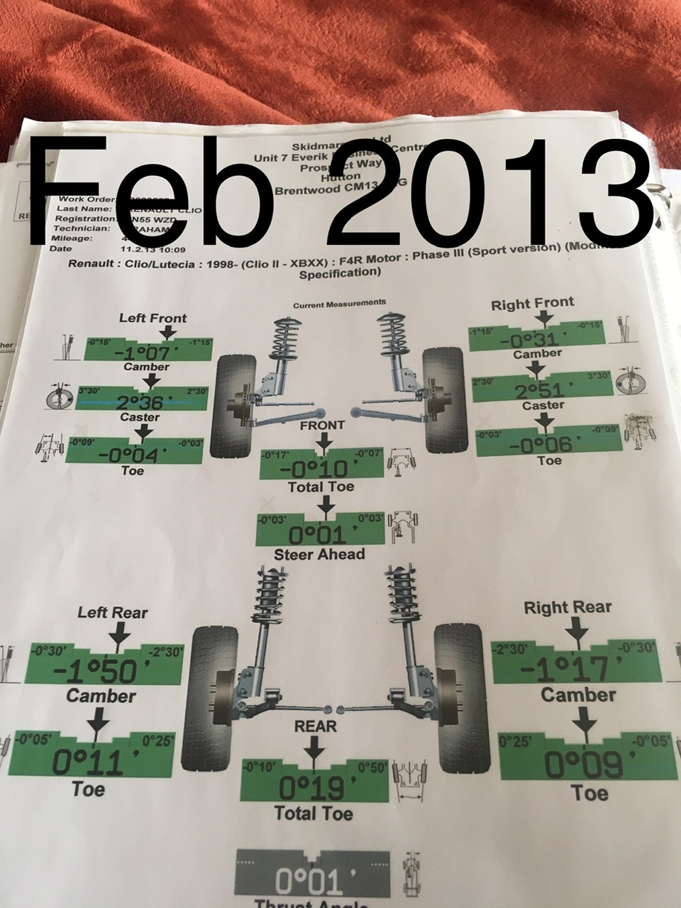

Puzzled by this is started to look back through the cars history, and found the caster angle has always been lower than expected, so clearly nothing I’ve done since has altered this.
As said, I’ve seen standard cars with more caster than this. If we are splitting hairs, in theory I’ve got a slightly lower rake angle (front to rear) over the whole car so should have marginally increased the caster that way anyway.

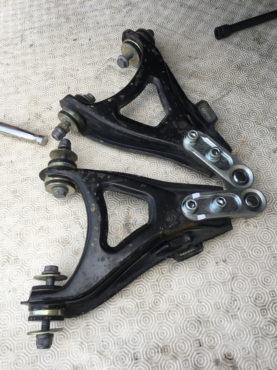

You can see from the images below the offset drilling’s in the arms indicating these are indeed genuine Cup arms. The Powerflex bushes are up against the machined stop indicating the arms are in their correct location. I don’t wish to run the AST topmounts as I prefer the design of the PMS variants with the associated brace and have seen the turrets fail with the ASTs.
So failing to re-drill my lower arms to offset the lower uniball carrier even further.

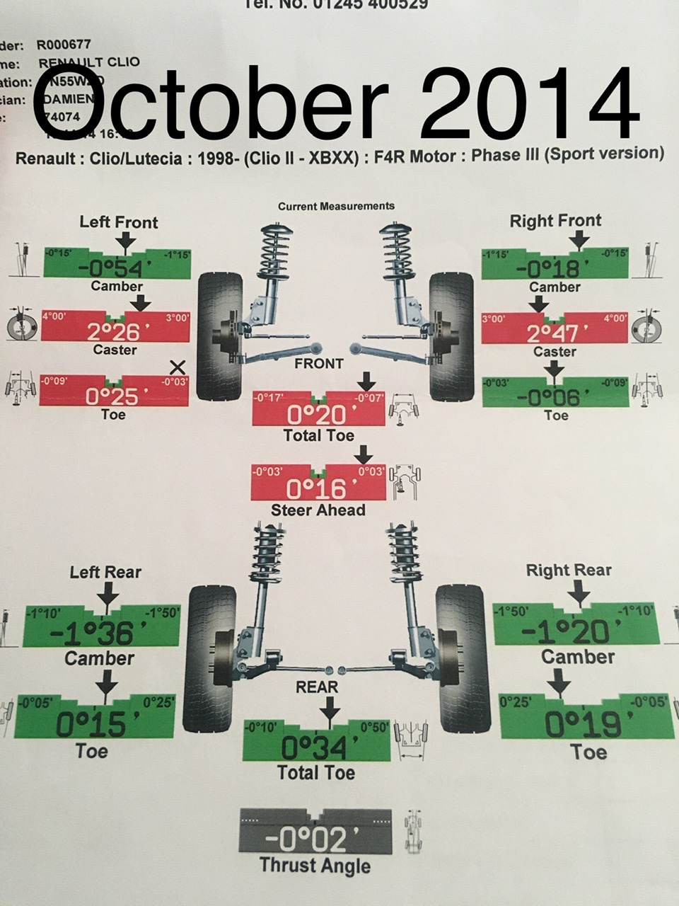

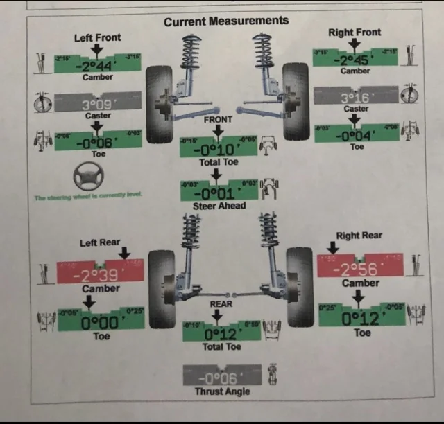

This is my current geometry.

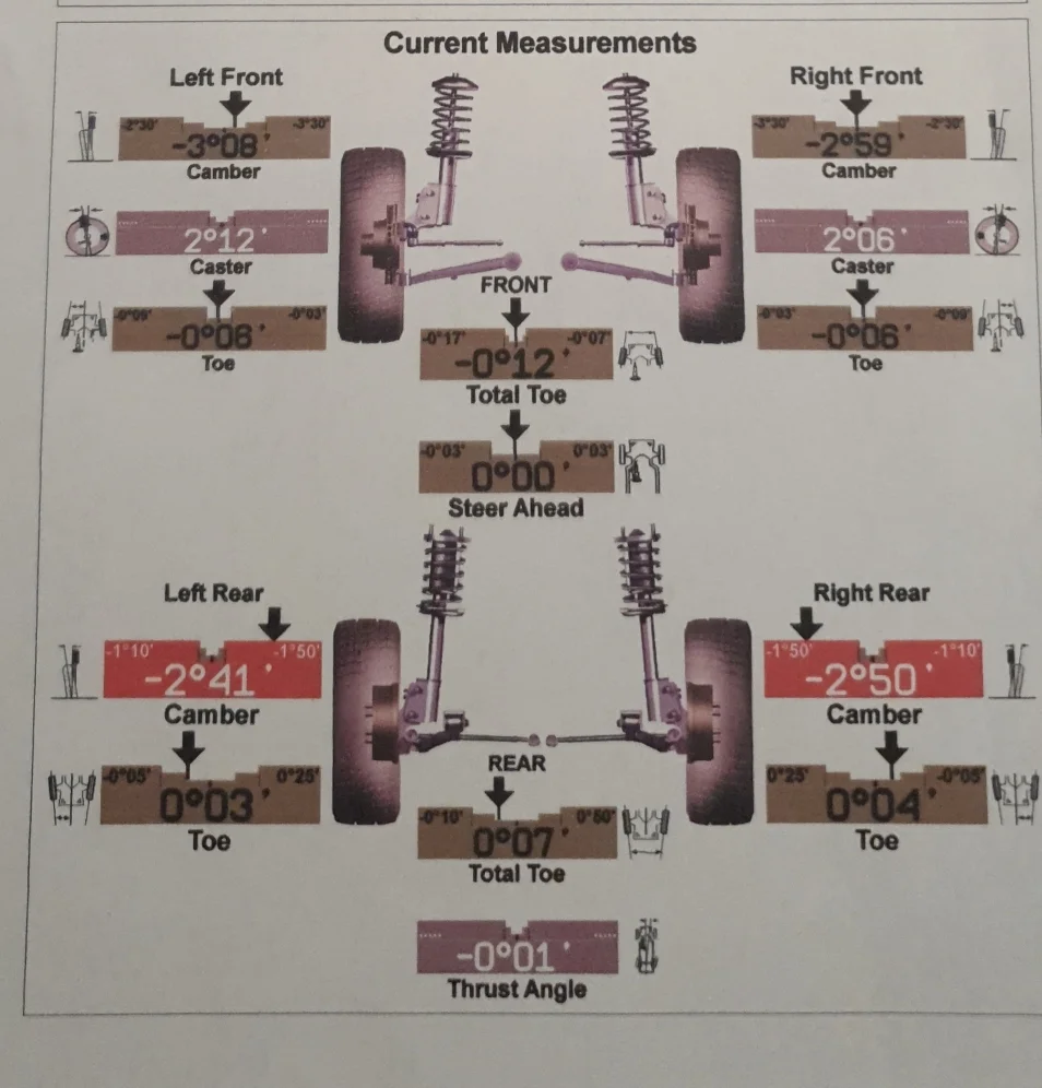

This was back when the car was stock.
Are they configuring the machine to read the actual caster? Because when I got mine done with corner weighting it was 4.6 ish, then some time after a quick toe setting at kwik fit with tyres was 3.2
Not sure really mate.
You’re always limited with these places as to how well they know how to use the alignment equipment they have or if they just make it all “green” on screen and give it back to you.
I used to have a fantastic alignment place local but not anymore.

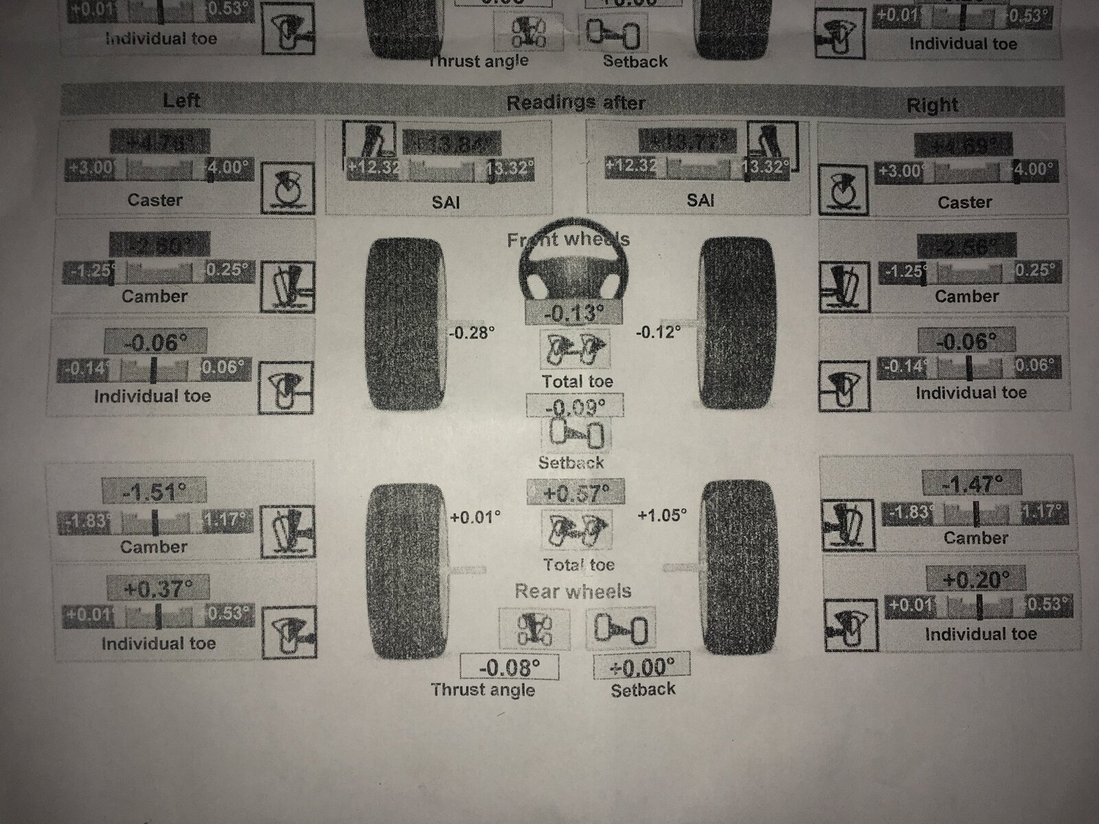

My car is always Aligned at the same place and they really really know what they are doing.. They align race cars all the time.. My caster before Roll centre correction kit was roughly 3ish. Since fitting the RC kit i lost about 1 degree.. Nothing else was changed on my car..

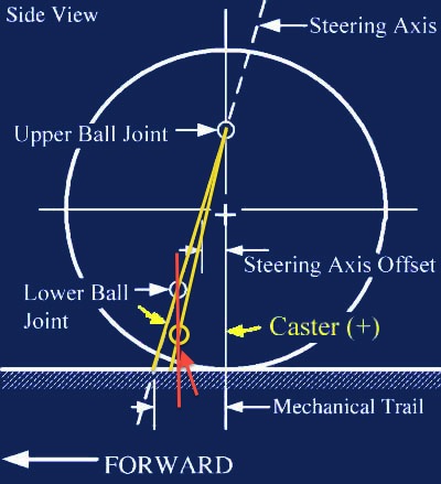

Dude wheres my caster?!

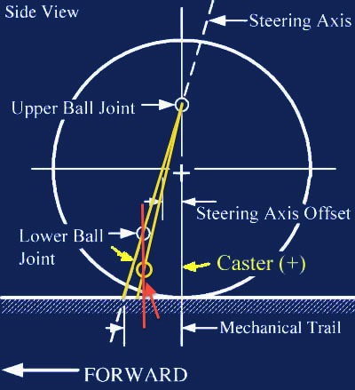

Red arrow shows new location for lower joint, thats what could of happened. Or that Im wrong, or the alignment people didnt configure for caster, or it wasnt taken into consideration in the design.
Thanks Zach, as I suspected.
But that doesn’t explain the zero change in caster post RCC hubs.
It’s always had less caster than desired.
So whilst your drawing makes sence in theory. It doesn’t appear to be the issue I may be suffering from.
If indeed I have an issue at all 🤷🏽‍♂️

I know 100% mine were done correctly and i know 100% i lost 1 degree and i know 100% nothing else was done apart from RC kit..

If there is a significant caster change, its just a thought, thats why mine has 4.7, because Im lowered on asts with adjustable top mounts and wishbones increasing camber, there may be an increase with the wishbones.

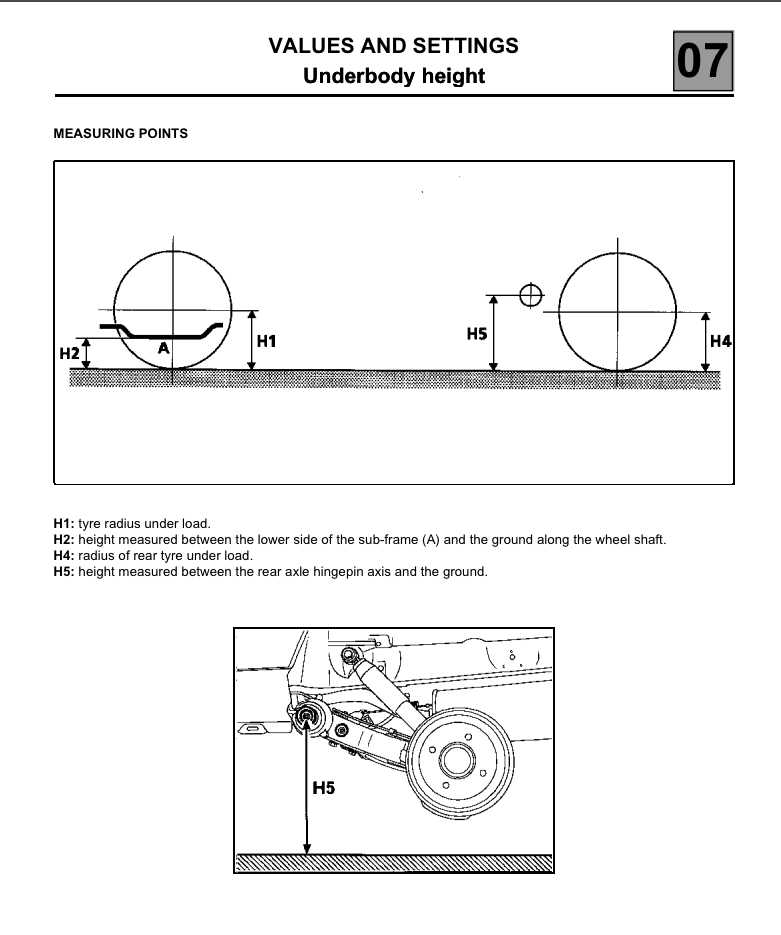

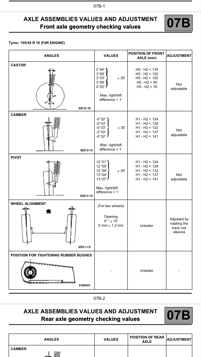

Where and how do you measure the H2 H5?
Sent from my SM-G977B using Tapatalk
I have no idea, never heard of them.

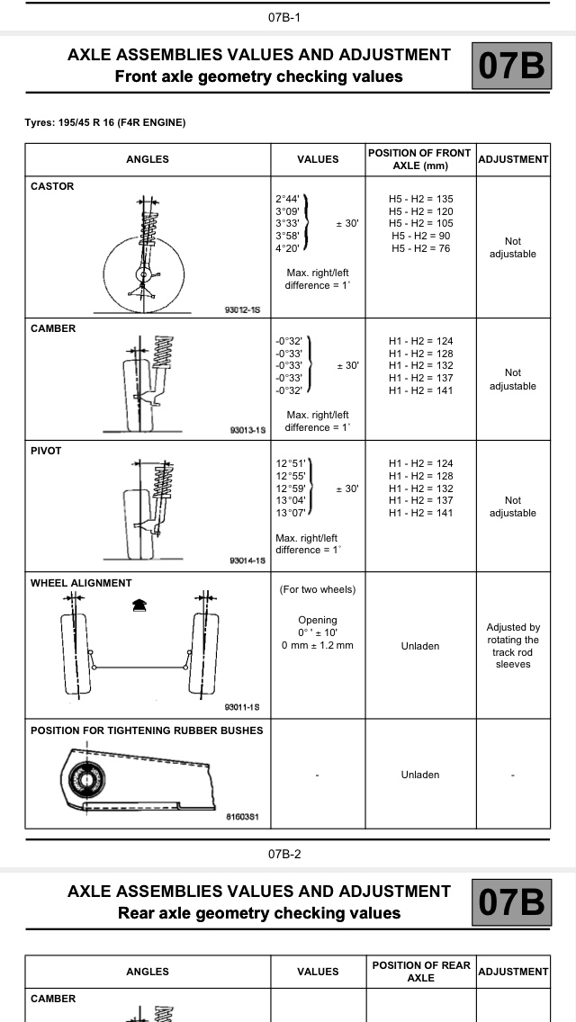

The tolerance from factory isn't 2.44 to 4.20, it's just +/-0.3 (+/-30' sorry)
The reason they give a range of castor values is so that the tech can take any customer car, with any amount of fuel in the tank or s**t in the boot and get a castor target for whatever that particular car's ride height happens to be.
