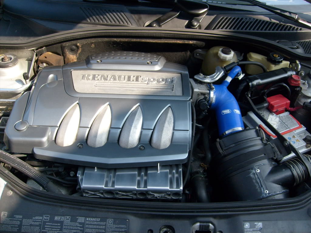

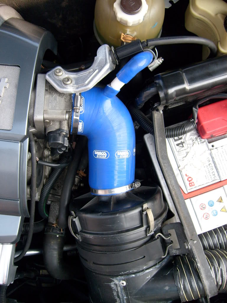

yeah i have a 70mm 90deg bend without the breather pipe and just fitted a small oil breather the idle valve same job and a hel of a lot cheaper,
you just need to trim the elbow down and remove the air box mounting plate and strap,

Mark's old pipe now on mine.

so where does the breather go then al it looks like its not connected in that pic? so just order a 70mm 90 degre bend from samco and?

The oil breather pipe has been joined to the origional idle valve hose, where the jubilee clip is, as i didn't want to cut the origional pipe.

order a 70mm 90deg bend from sfs (then it will be the same colour)
fit your airbox as normal,
the small pipe you disconnected will need a breather filter fitting to it,
connect that and its done,
