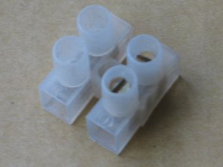

You dont need to chop the black connector off but it does help if you can/want to. if you chop it off so that you have some wire left on the black connector part you can use a choc bloc to reattach it when you come to put standard seats back in.

Boosh - If you follow the mini write up/things i've discovered thing i did on P2 along with the picture of the block connector you'll be fine :)
As stated above the block connector is just to make life easier (no reason you couldn't perservere with the OE plug).. I pissed around with it for a few weeks before getting frustrated and chopping it... benefits of using a BC are that you can physically see the connection - so its one less thing that could be faulty/incorrect.
As long as you chop the wires to the plug off halfway between the sheived section and the plug then you'll have enough left at both ends to reconnect the plug to the wires using a BC should you choose to revert back to the OE seats in the future.

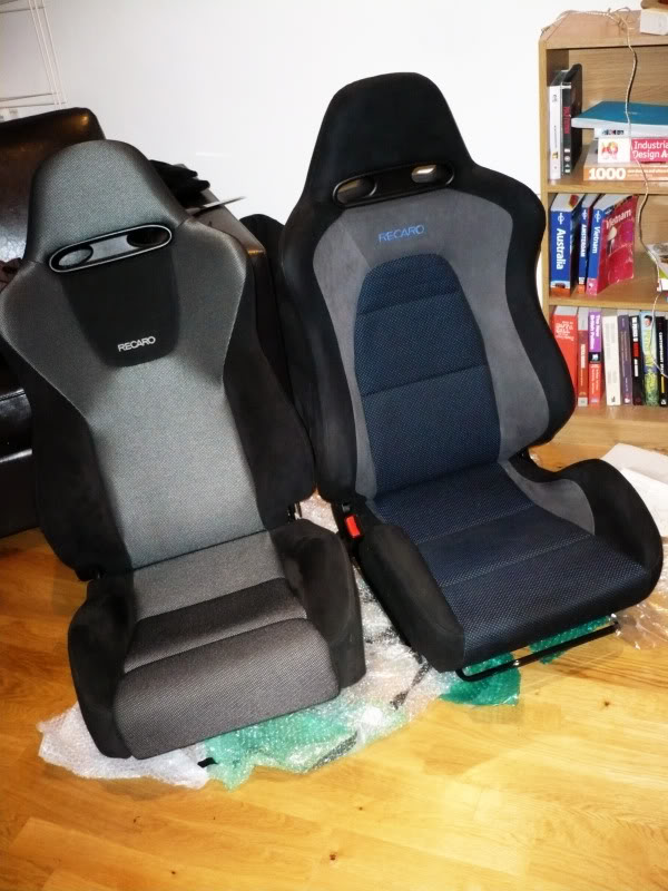

Anyway.. what seats are you putting in? Piccys please :D
I've been alternating between these two
can't decide which i find more supportive.. am possibly tempted to go back to standard :S

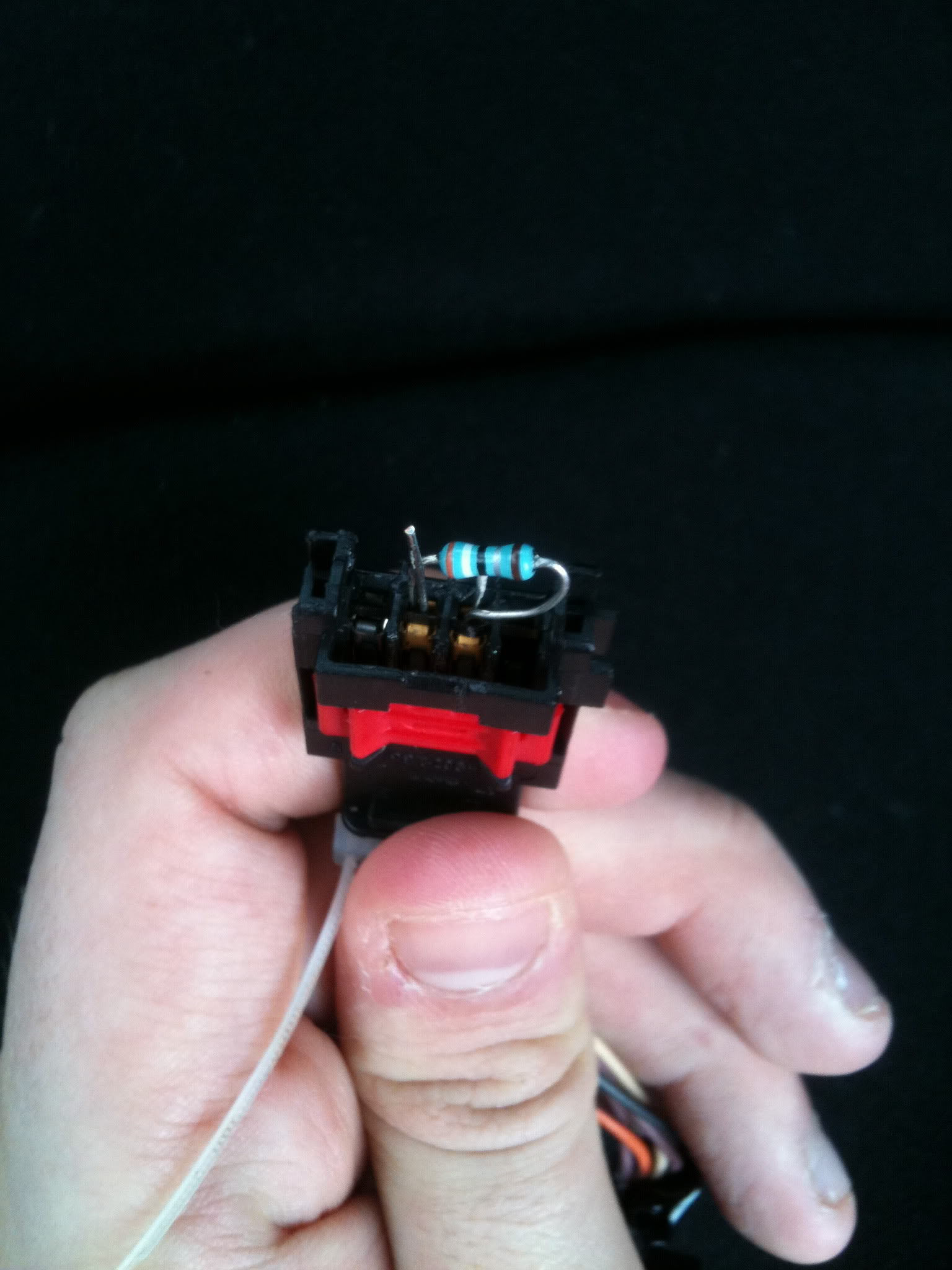

HEre is what i am doing...
1) bend the wire in half each side of the resistor to make it thicker - IE better connection...
2) putting the resistor down the brown wire
3) putting the other side down the peachy coloured wire.
Here is what it looks like:

Oh and to Fast AD. Here are my seats...
A bit hardcore agreed, but they give you so much more confidence in the bends. Hold you mega too, and suprisingly comfy :)

I tried doing it but it didn't work still :(
I doubled the legs on mine but they still weren't making the connection due to the plug being the length it is.. the resistor definately looks like its in the right holes though.

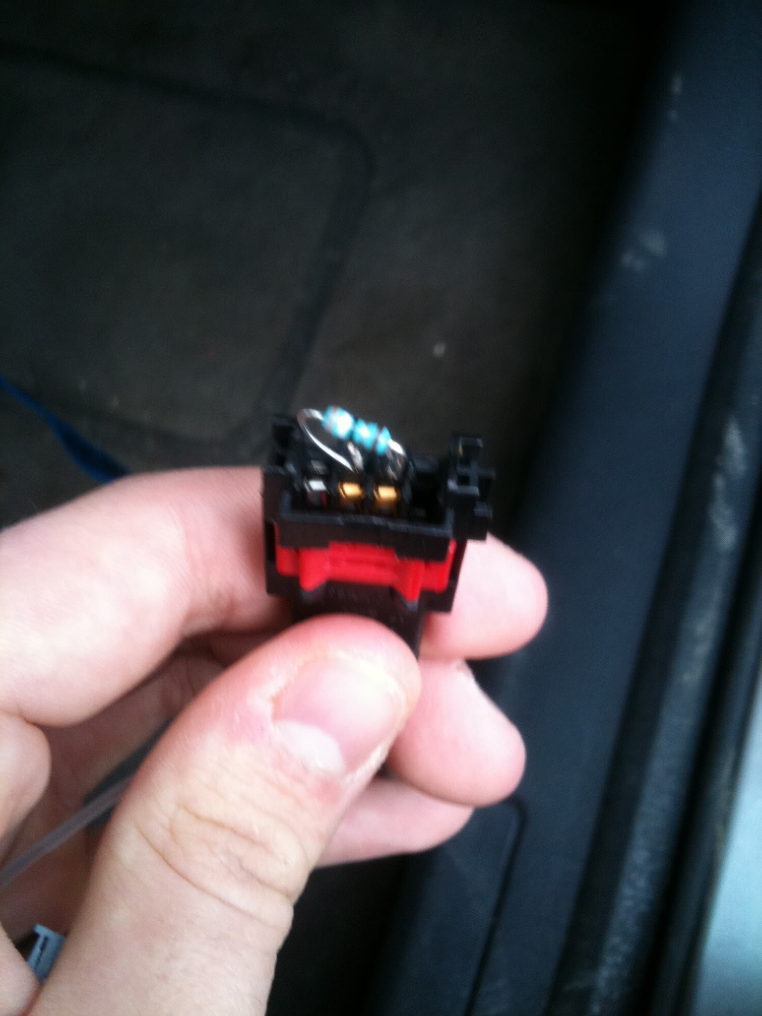

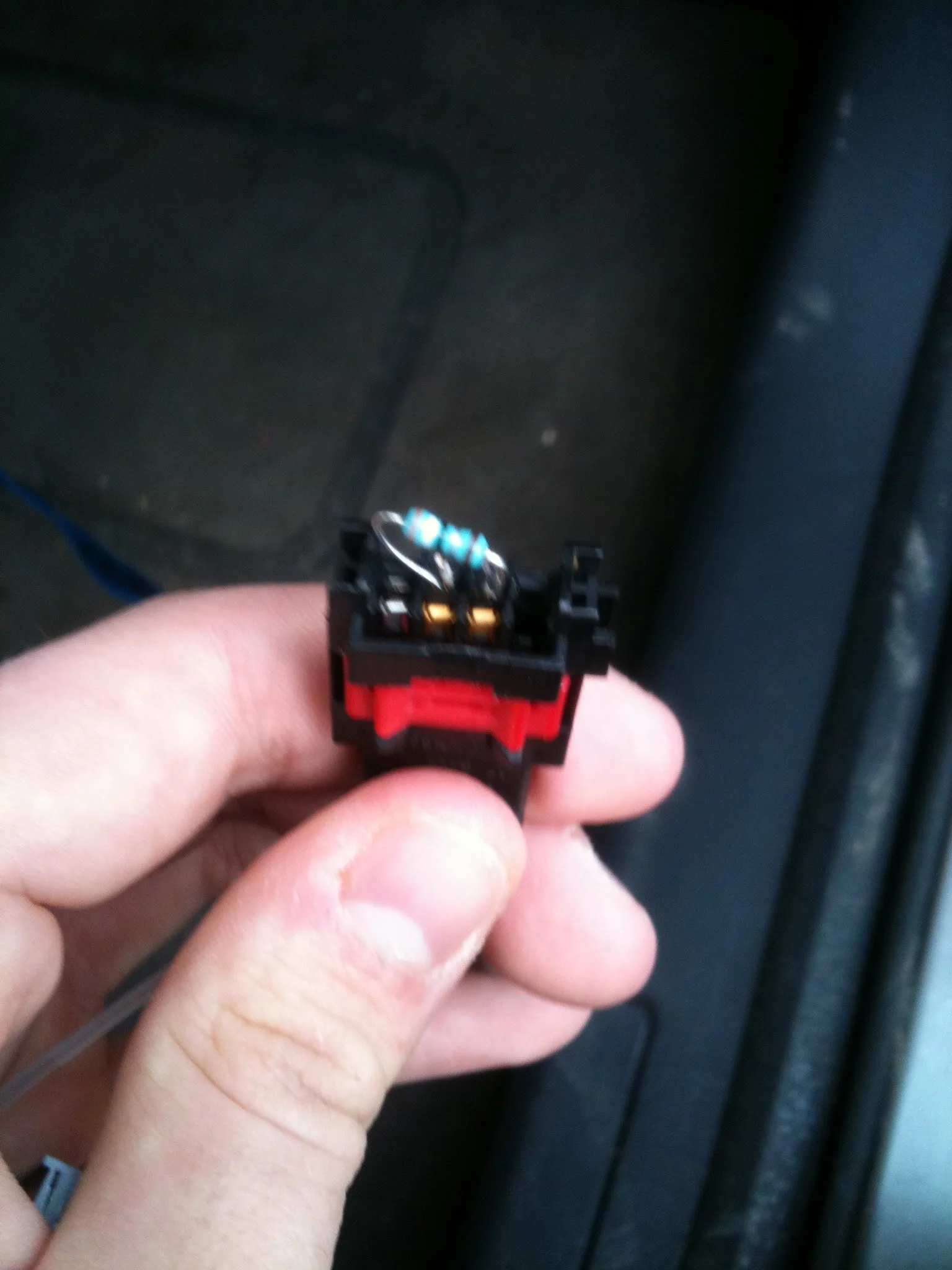

Man I still cant get my light to go off. Iv tried about 5 different types of resistors between 2.9 and 3.9 ohm. Iv took some pictures
Am I connecting the correct wires? Iv left the black ones out and used the brown and lighter coloured wires.
They are getting a good connection and Iv no idea at all why its not working

Dont you need a resistor in both connectors?
I followed boosh's guide which is somewhere and it worked fine, has been for over a months now :D
