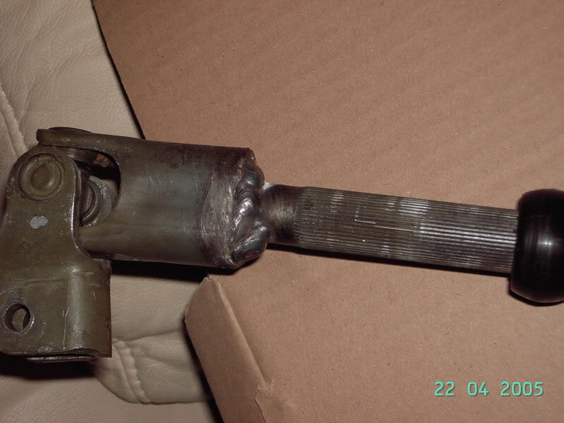

Where is the bit on the steering column that needs welding????
Paddy_g46
where is that bit? is it accessable from the drivers footwell?? can you weld it in position?? also is there any other way of doing it apart from welding it??? can i stick a screw in it or just stick a wedge in each side???? and also wen you fix it do you have 2 make sure it is in the middle or can it be to 1 side???

Its the bottom of the steering column, don't think it can be welded in situe I think it has to come out although i'm not sure.
  HBT 172 Cup
Drivers footwell, underneath the black plastic boot where it goes through the bulkhead.
Pull the boot of and you will see it, and yes it can be welded in situe, just watch out you dont set light to the carpet :D

ok cheers mate ill go have a look, does it have to be welded or can i just wedge both sides with cardboard bodge styleee? lol
  Valver
Has to be welded mate, not that hard and tbh might as well take the column out to do a proper job isn't difficult to do.
  HBT 172 Cup
No it doesnt have to be welded, you can actually stuff a load of resin stuff like TigerSeal into the joint and let it harden, i know someone who has done that and its been fine so far (5000 miles i think).
But welding is the option that you know will last forever.

yeh but if i can bodge it even for a year or so id be happy lol, will be alot easier then welding it seen as i dnt know how to weld! lol

You can bodge it for a few weeks like i did i crammed a few nails into the gaps . I got it sorted as soon as i went home as i was at uni and couldnt afford to get it welded at the time.
My mate welded mine its a 5 minute job, its not worth risking your safety just bodging it so get it sorted properly, feels so solid now compared to before :)

do you have to make sure its all alligned or can you just weld it however? im gonna need to get my tracking done after anyway so i suppose it wont matter if it is a bit out!
  172
Just centre your steering wheel and wheels and weld away, doesn't have to be neat as long as you fill the gaps on each side. Keep a bucket of water by your side :rasp:
i welded mine last week just did it with a stick welder done it on the car no worries just tack it (or get someone to ) then weld a bit turn the steering wheel then weld a bit more ectect! took 15 mins made it 100% better i could'nt beleve i was driving with so much play,it was all over the place. just put something down so you dont burn the carpet ect.

You can pick up columns pretty cheap just change it over? No point botching it as it isnt a difficult thing to take out/weld or jus replace.

im getting this done 2morow by a local guy for £10-£20 he said which isnt to bad, he was just a bit worried about if there are any fuel pipes near the bit of the engine area???
