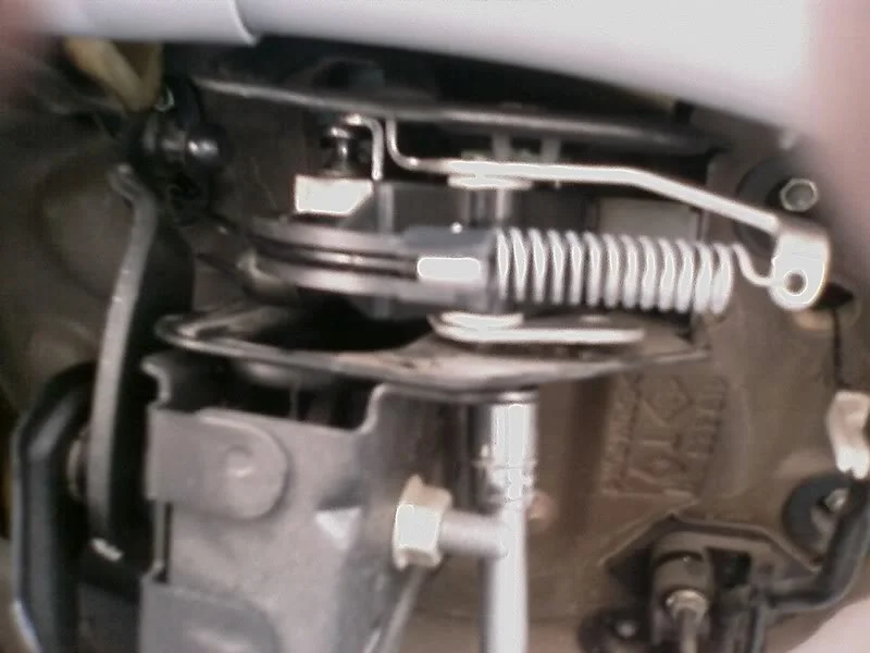

Where is the clutch auto adjust???
Car  PH1 172 Sport
As title really where is the auto adjust ratchet as ive looked at the pedal assembly where I assumed it would be and I can't see it!! I think it may be missing some teeth so I just want to check it.
Thanks
Im sure its at the top of the pedal, you have to take the lower dash off to see it properly.
my clutch pedal has been creaking for a while, i diagnosed it wasnt the cable, so today the dash came off and i set about cleaning and greasing up all the moving parts of the pedal assembly.
its now 100% smooth and creak free :D
This might help...
I changed mine recently its quite easy but i did do it with out the dash in. There may be some heater ducts in the way or something
