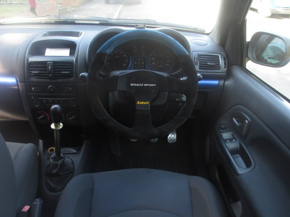

I have removed all my airbags and had the light turned off with CLIP it still comes on with ignition but goes off as it should for MOT.
If you are changing steering wheel and removing airbags you need to make sure the car is looking like a track car ie no back seats harnesses etc so it is classed as it is done for a purpose not just a chav taking stuff out.

Mine has failed mot for airbag light even though I have turned everything off on rs tuner and removed all airbags and components. The light comes on with the ignition and then goes out as it should. Some people just get power crazy and do things to spite people.... on to the next testing station
