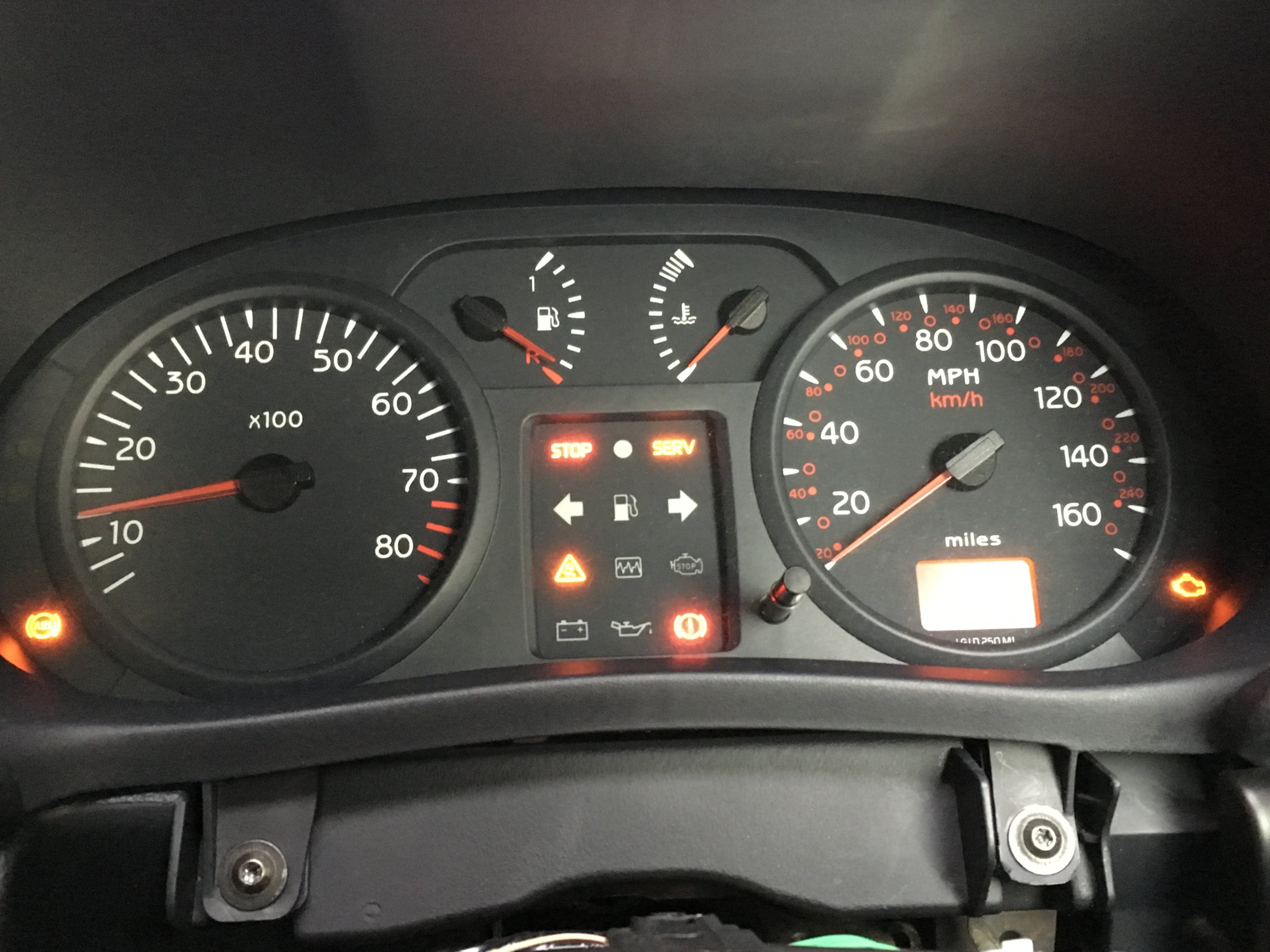

Which dash lights are an mot fail?
So the airbag light is an advisory(?)but since removing the abs I now have; Abs, esp, stop, emissions light
Could I tape up the abs and esp lights?

There is a really easy solution to this which works as I tested it today.
You take the clocks off, remove the torx screws and needles, then take it apart to reveal the circuit board.
For the airbag for instance which will light up the SERV and Airbag LEDs. You use a soldering iron to desolder those LEDs , you then use some thin wire to power the removed LEDs from a near LED that works as it should. Obviously use electrical tape on the original solder points youve desoldered on the board.
For the SERV you splice power from the Petrol warning LED
For the AIRBAG you take the power from the EML light or just use longer wires to get power again from the petrol LED.
That way all the lights will come on when you switch the car on and go off after 2 seconds.
Use some electrical tape to make sure the LEDs are all where they are meant to be.
Obviously when you run low on petrol your SERV and airbag LEDs will come on too lol.
Works fine and the LEDs wont be dimmer or anything.

Im just about to do this, grabbed a solder from my dad though the last time I used one was in school ha. what type of electrical wire do you use? Have no clue
Gus
  182Turbo,DCi90
small as possible. I used a network cable (ethernet cable) I just pulled 2 strands of the inner cable. Other cables that are good that you might have kicking around is an IDE hard drive cable, usb cable. Just needs to be a small wire as its only carrying a tiny voltage for an LED.
pay attention to the LED polarity - they only light one way so if it doesnt work first time turn the LED around.

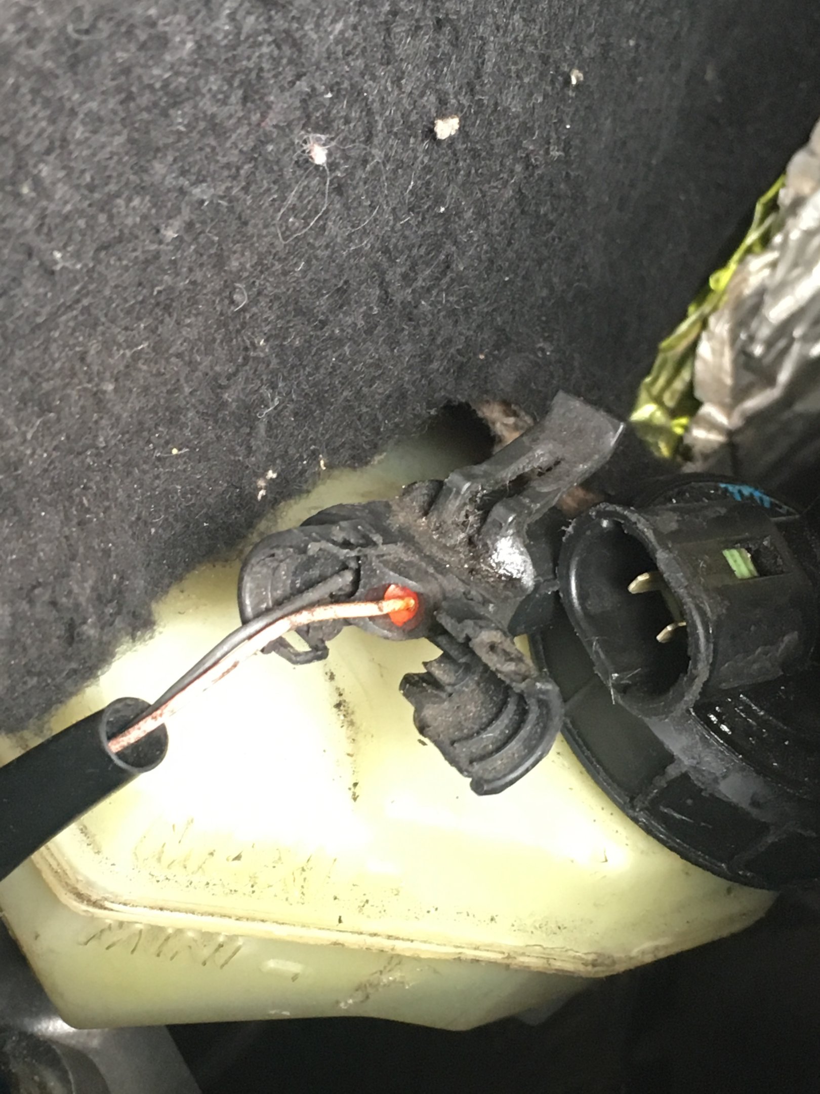

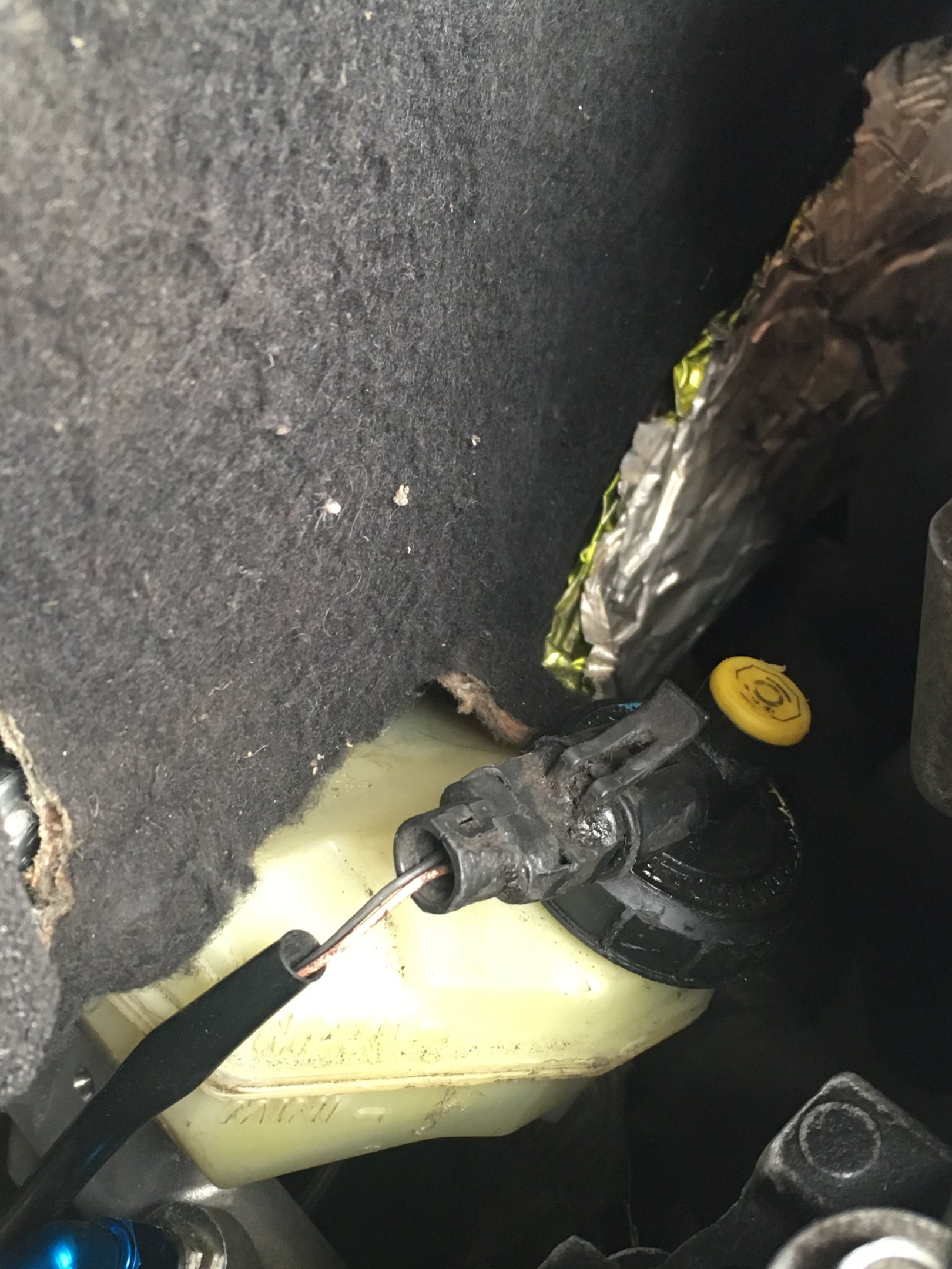

Also the handbrake light is always on, with stop light, is this to do with the brake fluid sensor?
@bloke
I take it that the light turns off when the little metal clip stops touching the metal? If so its not that :/
Rear callipers have been seizing a bit recently, is temperamental but could it be that?

get it plugged in and see what it brings up, not much that will bring it on if everything else is off.
  dan's cast offs.
worth getting it plugged in, just because there are loads of lights on doesn't mean it's going to be an expensive fix.
Was just thinking if theres any cheap fault code readers that would work fine? Or I could plug it into my laptop with the right cable?
  dan's cast offs.
cheap readers are s**t, cheap clip copy off ebay is worth having or the icarsoft seems ok, i've used one a few times now for the live data and graphing on it. you can get it with renault software on so it will read other stuff, not just engine related.
