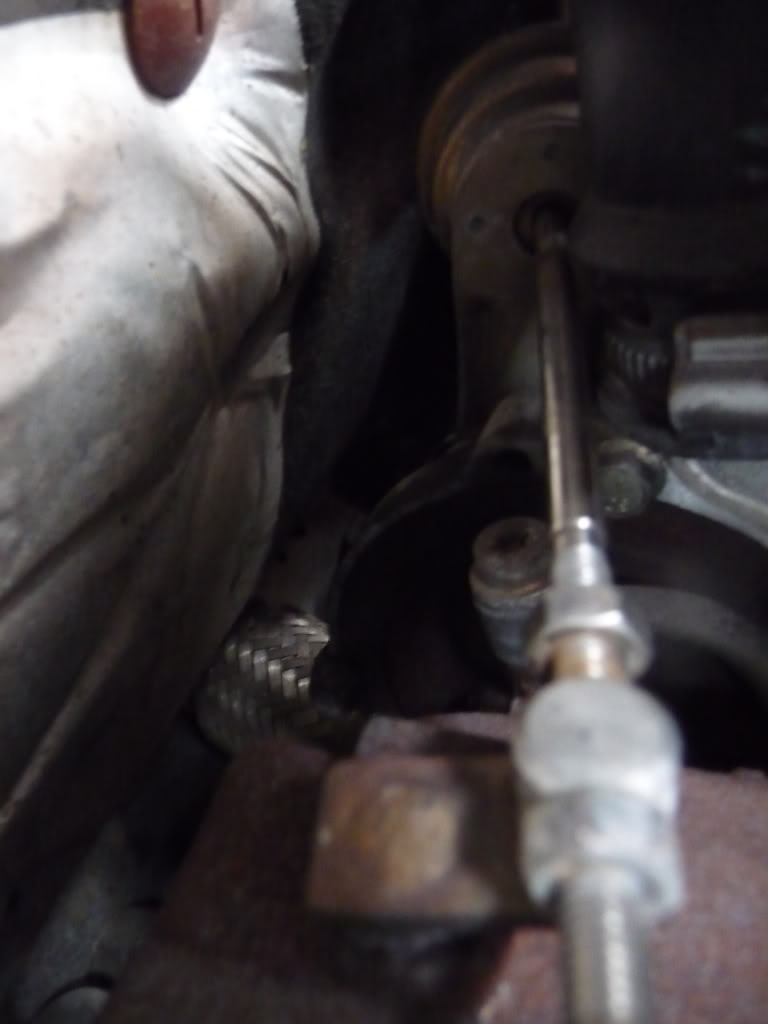

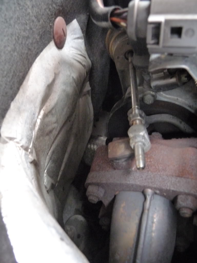

Hi all ,
going to turn boost up on turbo, also getting remmapped again.
i have tool all air box off my DCI and i have the wsegate in front off me.
just wondering which way to turn the nuts for a boost increase?? ;)
here are some pictures,
any help would be brilliant.
You offer a remapping service and you dont even know how to adjust an actuator?
More threads at the end of the rod will mean the wastegate opens slower, therefore increasing boost so you want to tighten the end nut
