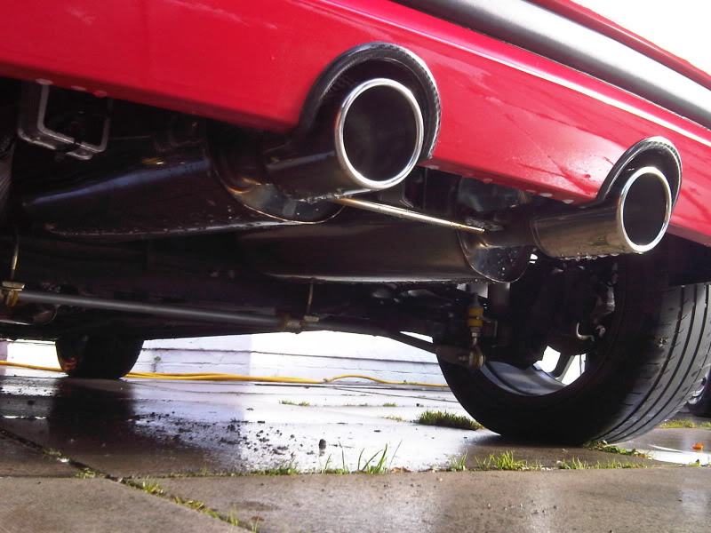

I fitted the roll bar last night and what a difference. The back end feels much stiffer and better tidied down. With the front damping adjusted the back end has more grip and feels fantastic but is easily adjustable on the throttle when the front starts to let go. A simple little lift will have the back end coming round and pointing the nose back into the corner.
I will try and get some pictures up later.
