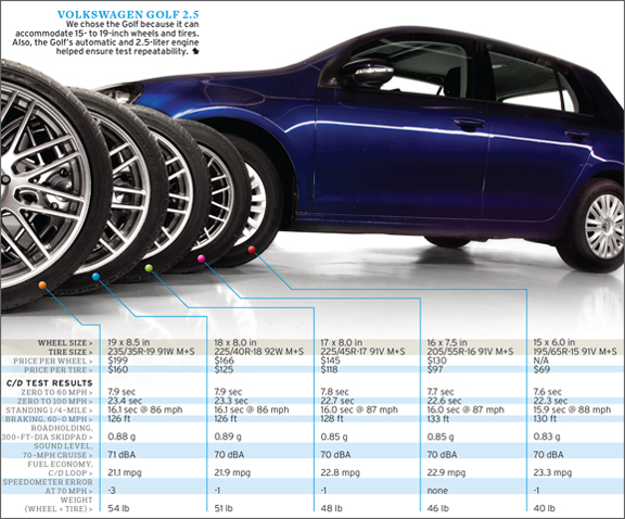

hmm... in this test they got the best grip out of 18" rims
Now obviously the Golf uses an overall larger wheel/tire but the best result was obtained with tires of height ratio /40 and /45
http://www.caranddriver.com/features/10q1/effects_of_upsized_wheels_and_tires_tested-tech_dept
  Stripped yozza'd cup
It's tyre dependant, I'm assuming they used the same tyres across every test.
But you won't find a race car that uses low profile tyres, so that says it all for me.

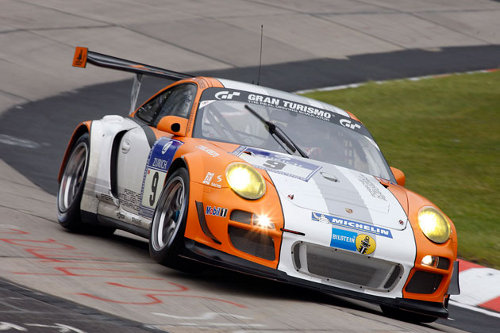

  172 ph1
I hope you're kidding :rofl:
Before you post a picture of an F1 car - they've been using high profile tires due to historic reasons, not technical.
There has been a push to move to lower profile tires in F1 as tire deflection is the biggest undamped "spring" in suspension tuning
  172 Ph1, Lupo GTI
those are not as physically as low as many road tyres though...
though technically as the profile is worked out from the ratio of width to height they are 'low profile'
Race tyres run a stiffer side wall construction than a road tyre so the effect of reducing the side profile is less of a benefit.
As kam says, those aren't really low profile tyres though are they? Also, driven wheels on race cars tend to have a deeper profile tyre due to their ability to store torque, aiding launch.
Having low profile tyres on a road also massively increases bump steer, tramlining and understeer/oversteer.
  172 ph1
Christ, if that's not low profile then I don't know :rofl:
Look carefully at the height of that tire in the top picture and divide it with its width - it's around 410/20 or 410/25 if you were to put it in road tire terms
A quick look at the tires fitted to various types of cars on the road is also a pretty good indication. Have yet to see a high performance car with /55 or above tires
You wouldn't run 55+ tyres, that's a ridiculous thing to say. 195/50/15 is what I've got. The difference between a 45profile and a 50 is tiny anyway.
You're just being a tool. That tyre is not a 20 or 25 profile tyre, 35 perhaps.
