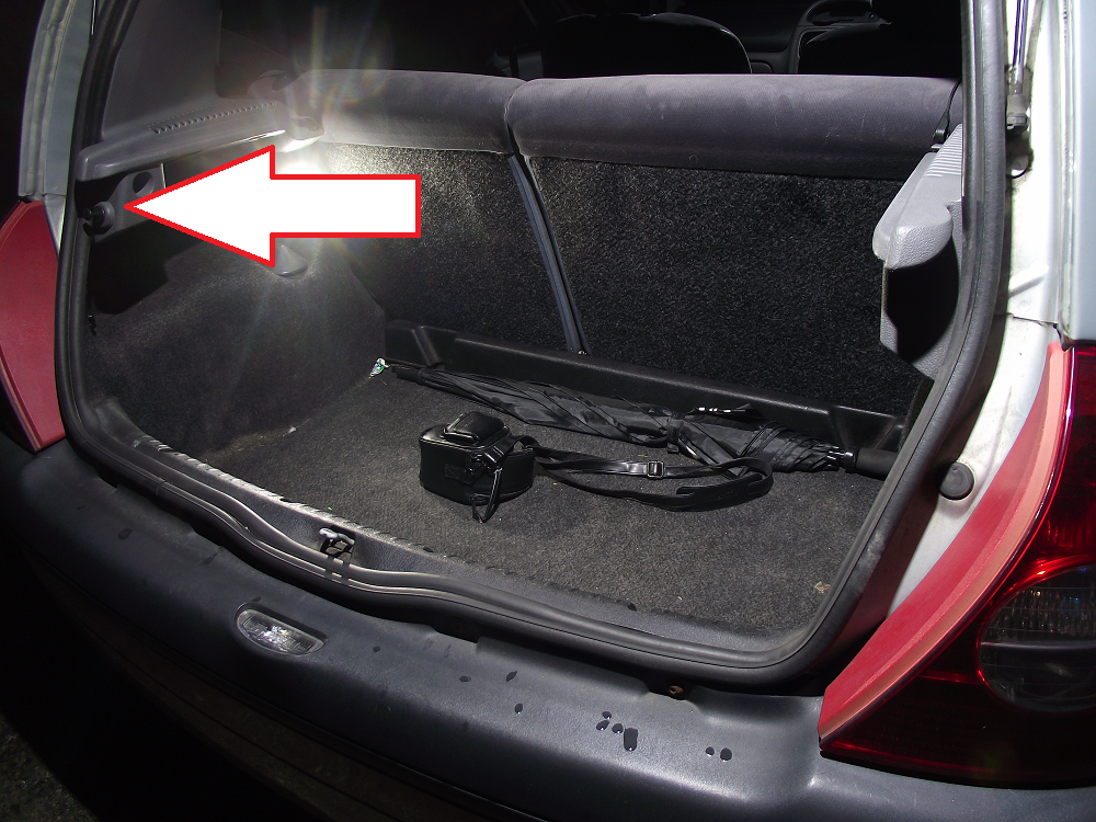

The boot switch is on the end of the parcel shelf supports (with the 'speaker grilles' on), the left one I believe. It's a little plunger.

Sorry not been online a while , cant see a switch under parcel shelf anywhere at anyside I assume its in the lock however mine is the ph1 pre facelift made in 2001

thank you very much pal i get i now , mine has that but its just a nobble sticking out no plunge switch on it and no hole where one would of been fitted so i assume its in the lock :/
