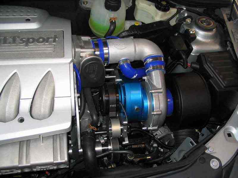

The company who make the supercharger in the picture above dont do this anymore as far as I know.
its just a near impossibility to work with the a/c equipped cars as drive for the supercharger is just impossible to get off the existing aux setup.
And the cup market is too small for anybody to really warrent any development intrest.
That setup might look tidy, but with zero intercooling and taking air straight out of the comp housing will lead to poor setup and performance, along with extreem det sensitivity as air temps can reach 100 deg and the knock threshold is 40.
