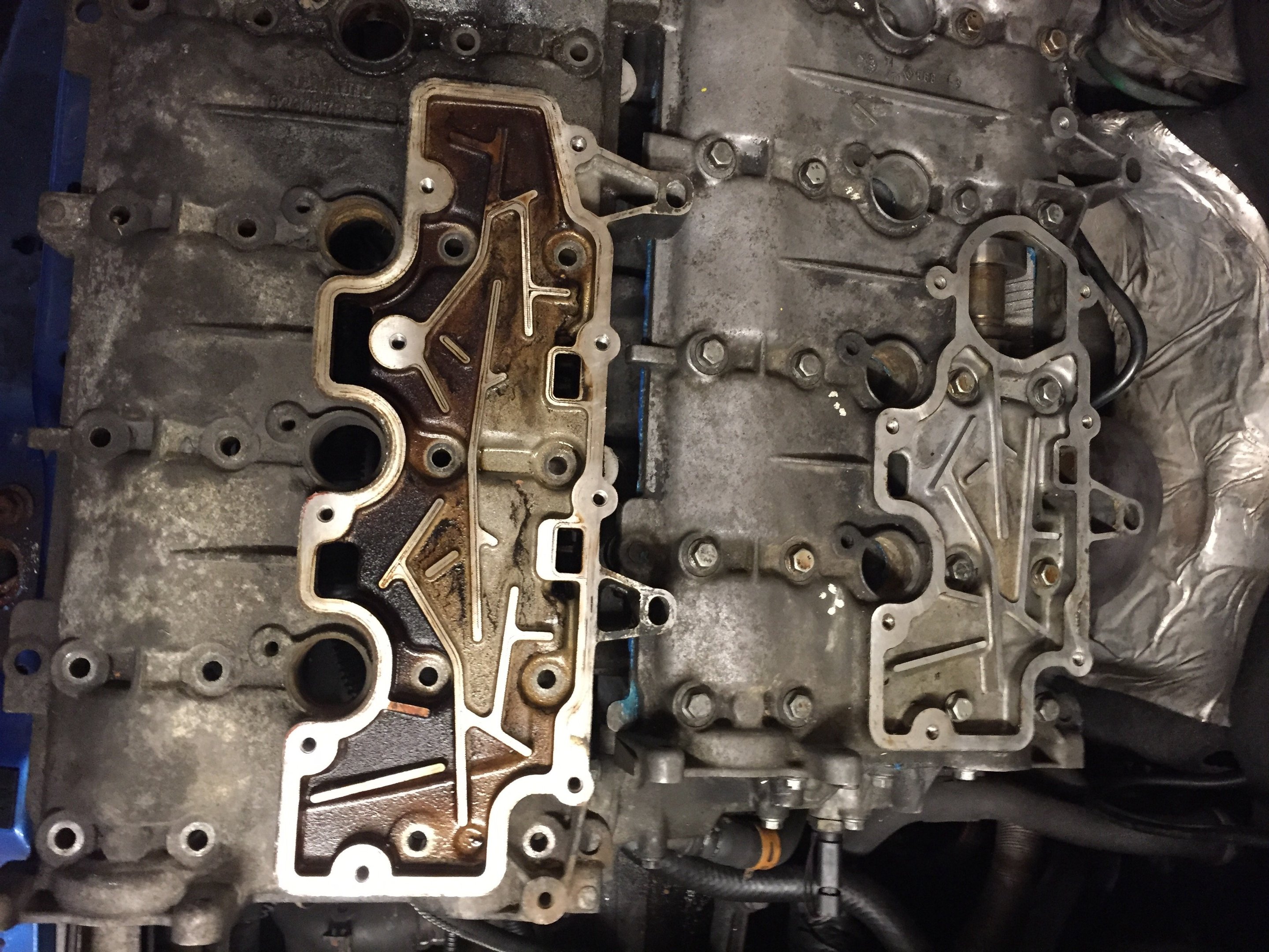

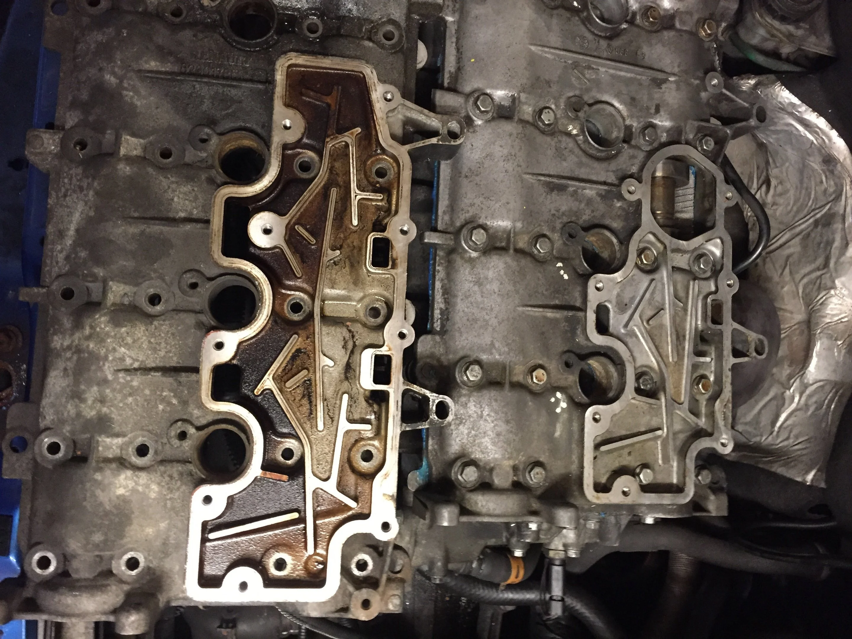

will a 182 oil breather plate fit a phase 1 172 head? If so how?
DAN HAMMOND
Car  CLIO 182
hi all, I have just fitted a phase 1 172 head to my 182 and I was told that the oil breather plate on the rocker cover was different to my 182! I am in the process of fitting it and my 182 breather is loads different! Any ideas please? Thanks
Phase one head has a smaller/different breather plate. Pretty sure you have to use the correct plate for each head.
It won't be problem using a phase 1 breather plate for your 182 bottom end..just need to find one thou.
Thanks yeah i will have to do a wanted add, I fid read somewhere that they are interchangeable but 182 breather plates are loads bigger! Many thanks for your help
