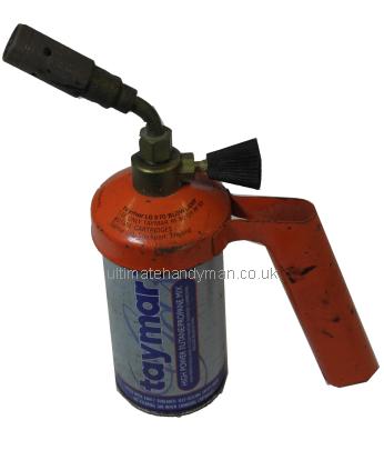

will this be ok for heating up bolts?
blow torch would be better mate. not sure if that will create enough heat really. blow torches can be found quite cheap.

Think you'l be there a while with that heat gun, Mine will burn wood but not that hot.
I'd get one of these from a DIY store or B&Q or plumbers store.
