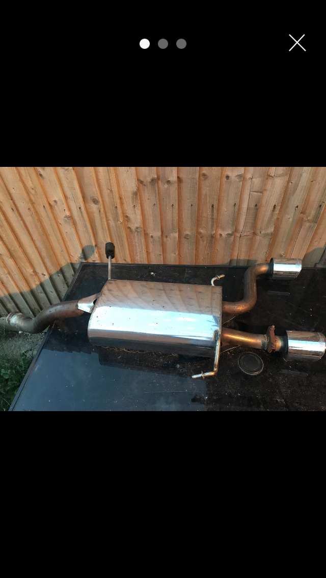

Hi I’ve been looking at a back box for my clio 182 and looking for advise. My existing exhaust is standard would I be able to take the old back box off and put this one straight on?
It’s a ktr racing exhaust (road legal)
Probs best to ask KTR, is it this system here??
The stock system has the backbox and mid-pipe butt up against each other, then uses a sleeve to connect the two.
Check that the one you're looking at buying connects the same way, if it's different it might be a problem.
Ah yeah I see what you mean and yes it’s the one pictured above.
