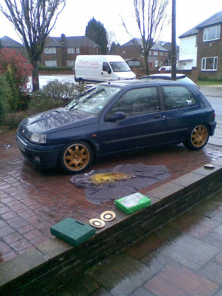

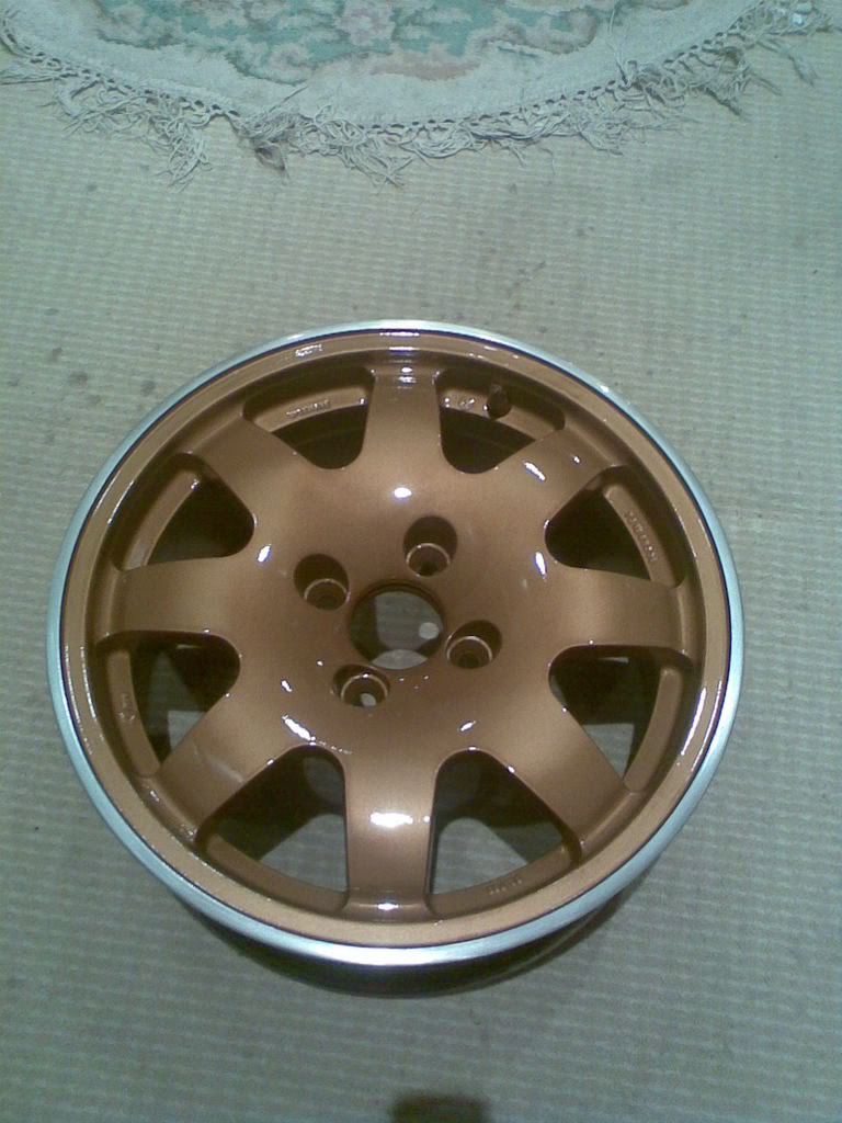

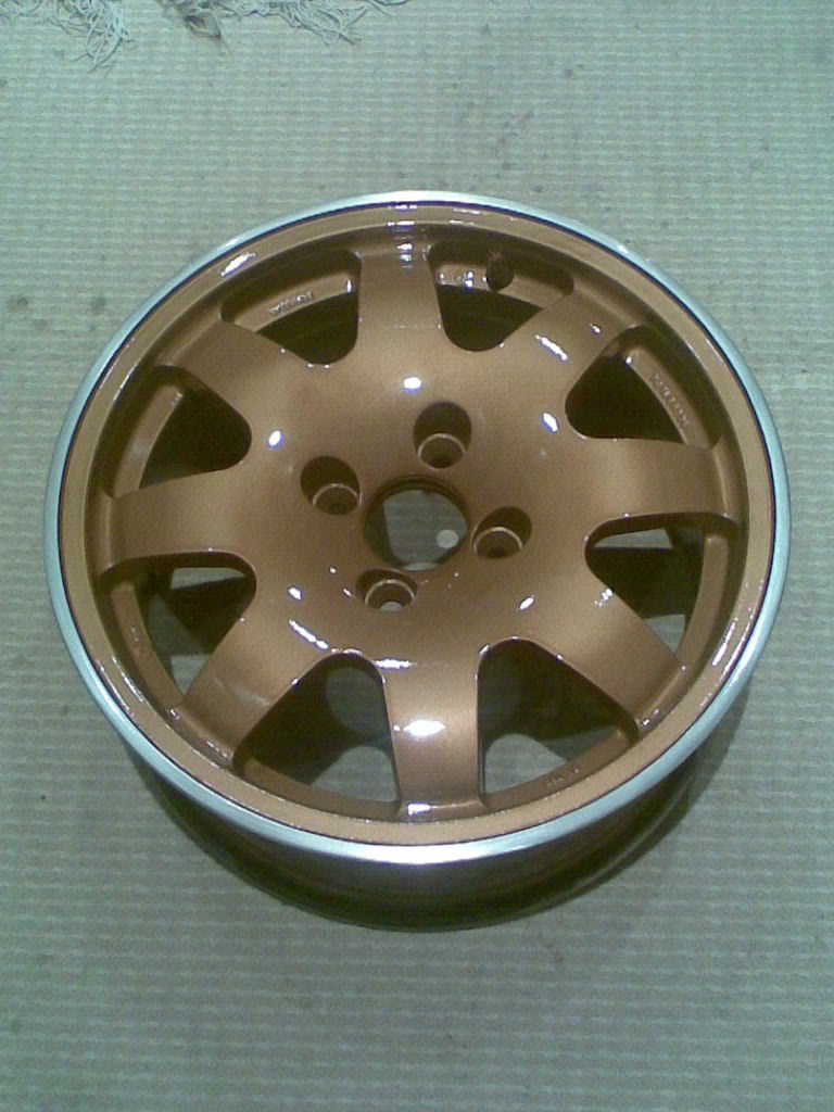

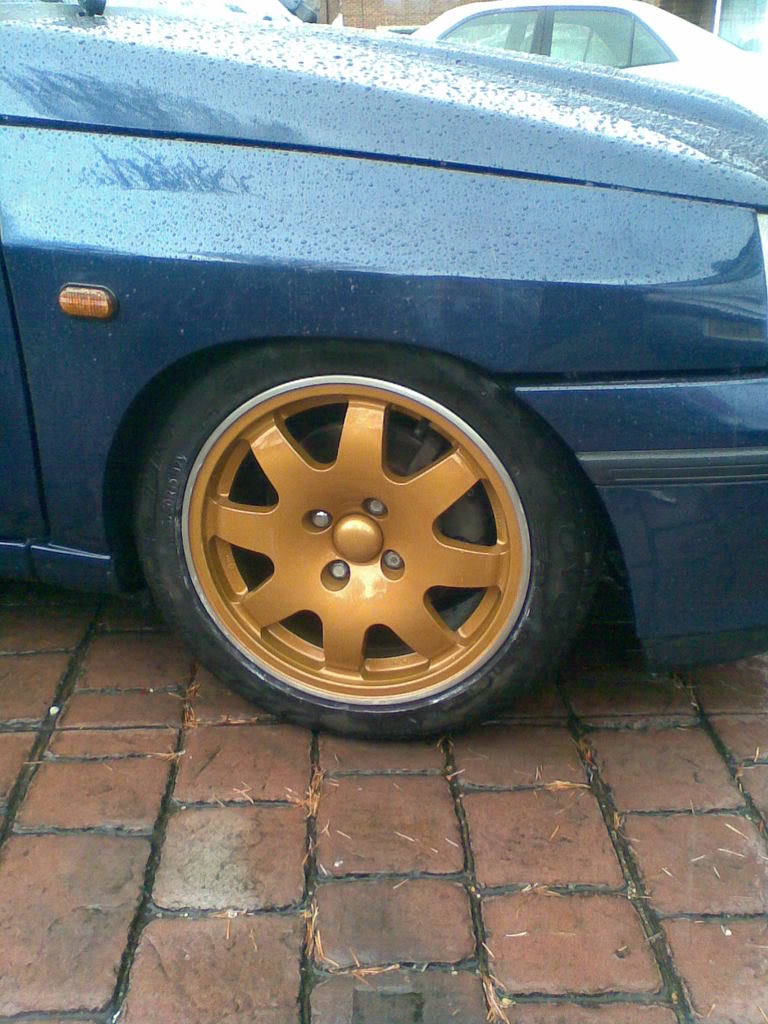

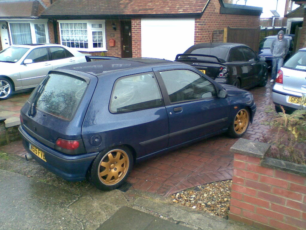

Just got these back from my mate who refurbs/sprays bodywork & wheels.
Cost me £150 for the set to be sprayed, not really 100% happy with the colour match as it looks quite bronze but none the less still happy :)
All Opinions welcome, and if anyone wants any work done just drop me a PM and i will let him know, his prices are good!
They are a bit bronzey yeah. It does look a good refurb though:) Silver willy wheels would look awesome (i've got a thing for them)
- I'll not comment on the black astra on the drive;)
  CS Dungeon
Colour is minging tbh
As he charged you, i'd ask him to have another go. I have sprayed 2 friends wheels and all its cost them is a ruby that evening.
Could of got them done in the right colour and powder coated by Freds mate for almost £150

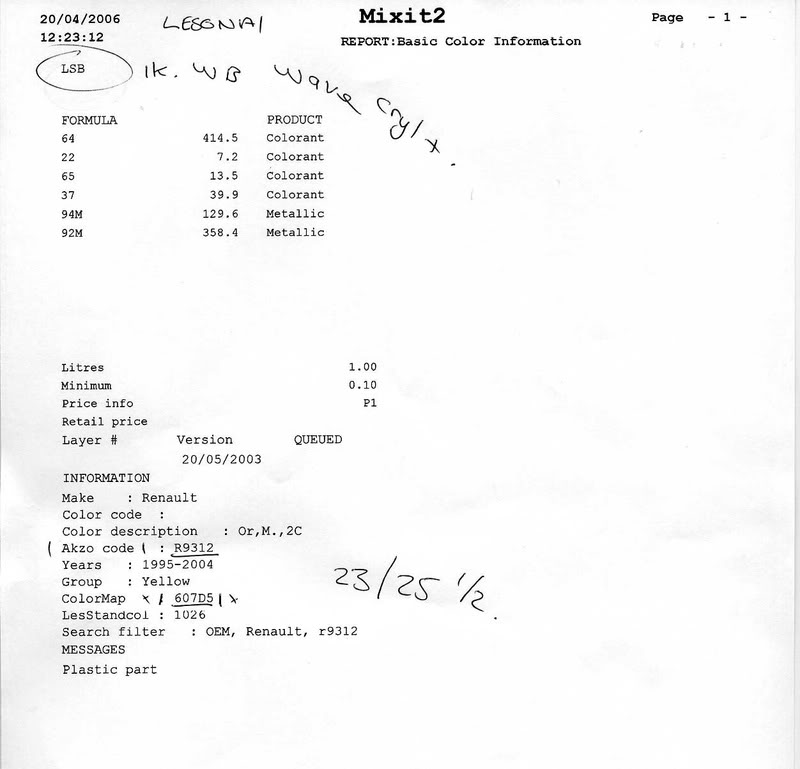

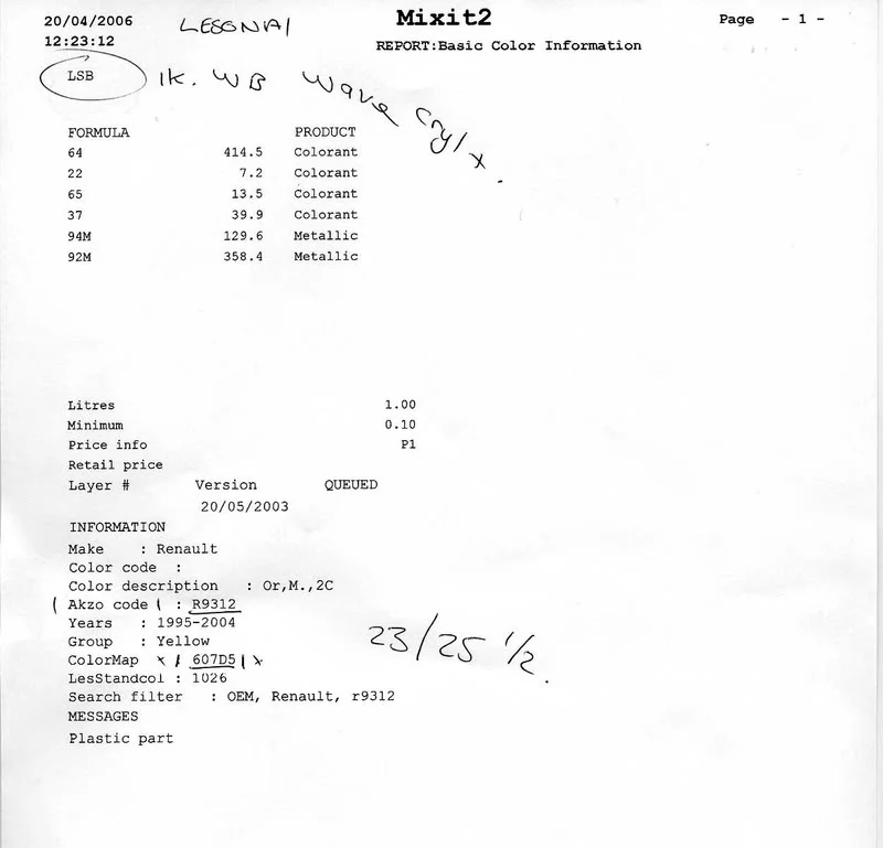

Could anyone post what paintcode is used for the willy wheels? he has charged me yes but his appollogises and said he will charge as little as possible to do again, its not his day to day job as he works in an office.
Ali
  V6, Trackhawk, GTS
Noooo!!!! You simply can't mess about with the colour of the willy wheels!! :( I'd be very disappointed with that!
  Valver
Only paid members mate, couldnt you post the info here?

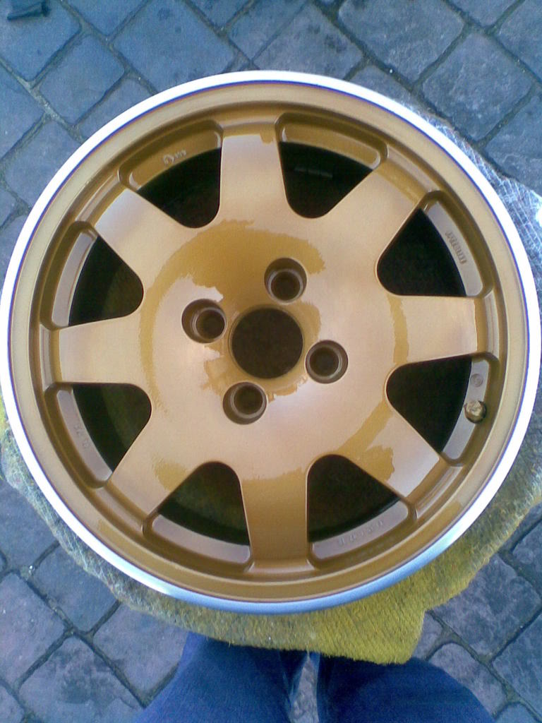

Well Ive decided that im going to stick with them for a while until i can afford to get them redone, and will get them done in the proper williams gold.
  Audi TT 225 Quattro
ok this is what it says in the thread.......
6. Base coat using speedline gold R9312
The gold paint I used is the offical Akzol Noble code supplied by Speedline Corsa. This code has been checked with Akzol Noble and the UK conversion is R9312.
