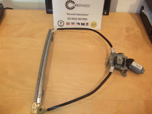

However, upon winding the window down (probably should have removed the door card to inspect first... but hey, it's done now) I have a sickening creaky noise & consequently a deeply scratched window. I removed the door card, rubbers & the rest and inspected the regulator mech to find that the welds have failed at the top of the metal slider (sorry - don't know the techy term for that strip of metal which acts as a guide) causing the glass to brush the metalwork of the regulator- thus the scratches.
So, it's new regualtor & window time I feel. The window glass is not a prob to find but looking on ebay, the choice of regulators is utterly bewildering. Could anyone point me in the direction of the right type of regulator?

its a mark 2 phase 2 no?
should be this but for opposite side no? hit up renparts mate :) im sure kat or josh would be able to sort you out!
