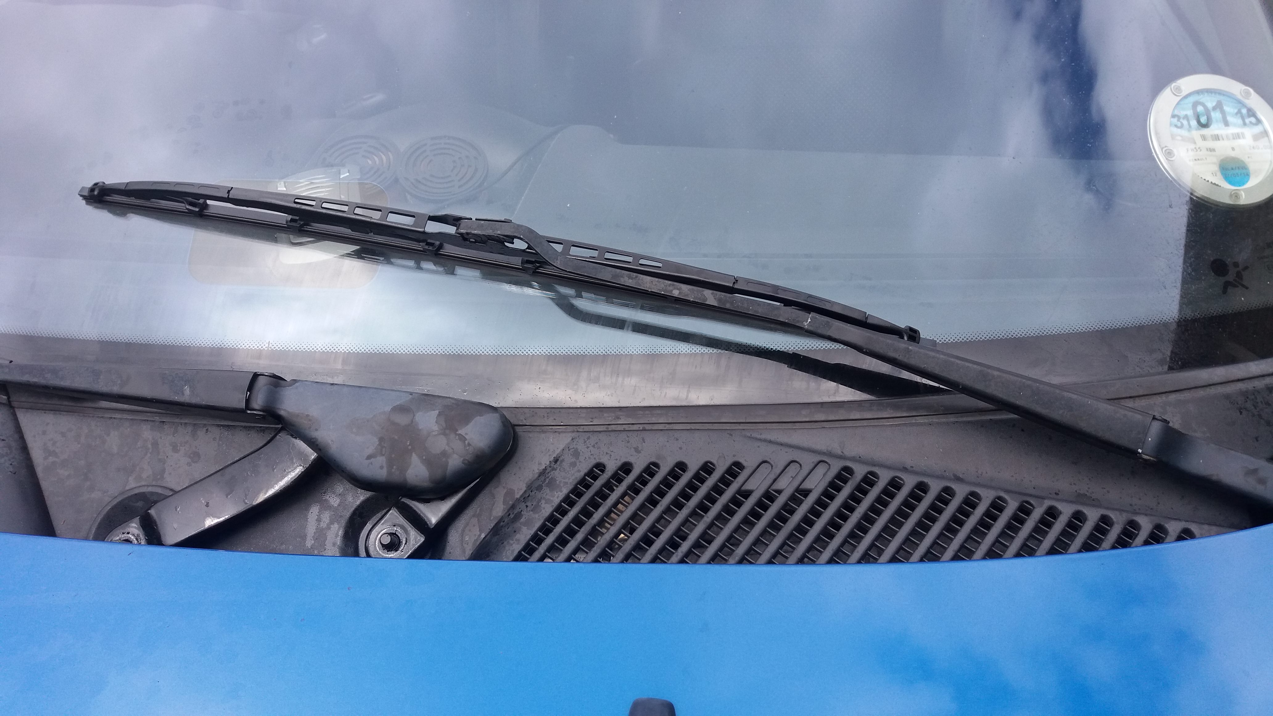

I noticed this yesterday when it started to rain a little bit .
In the auto position , it wiped as normal then suddenly stopped then started again after a few seconds . In Position 1 , the slower speed it works fine , wipes and never stops . When I put it in position 2 , faster speed nothing at all .

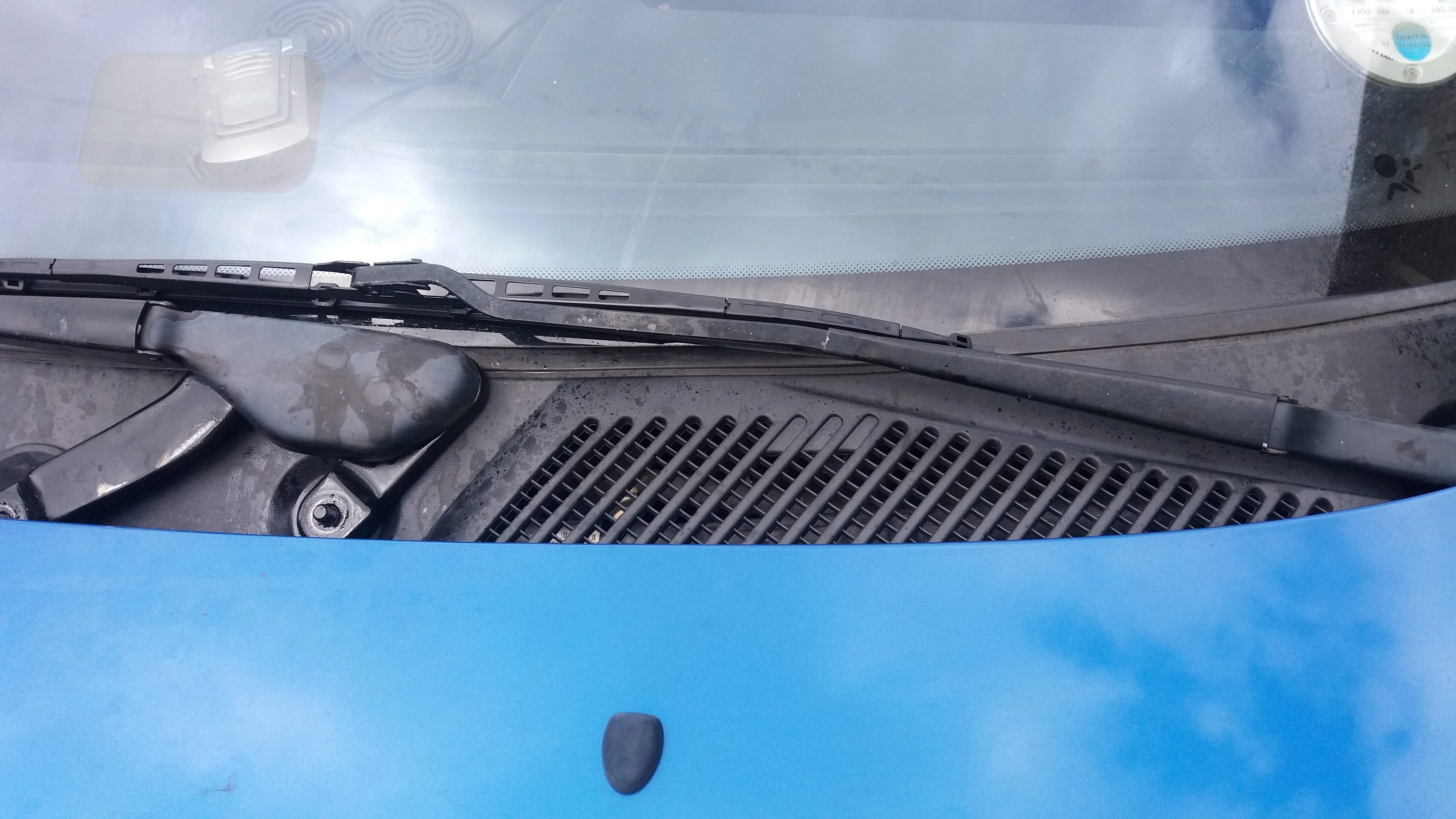

The passenger side windscreen wiper has been loose for a while. It stops about 2 inches for the normal stop postion . I can move it by hand about 2 inches up or down.
Does anybody have any idea what might be causing this problem? Is it just the linkage , maybe something else ? I've been soaking the 3 nuts all morning with plus gas in preparation to attempt to take off the windscreen wipes and scuttle panel . I'll go and buy one of those bearing pullersI've seen people recommend from Halfords this afternoon .
Any help would be much appreciated. I've searched CS and google but can't find the exact problem I'm having.
A couple of pics and a small video so you can see the position of the wiper.

I'd taken the nuts off to soak them windscreen wiper splines in Plus gas. I've been out tonight , auto would wipe sometimes twice then stop then sometimes 4 times then stop . Then all of a sudden Auto is working , position 1 slow wipe is still working but when I move it to position 2 fast wipe nothing , the windscreen wipers don't move at all . ?
Surely somebody else must have had this problem ?

Bit of an update . I took the mechanism and motor out. There's alot of play in the mechanism on the right hand side . I've reset the passenger side wiper so theres no play in that now . Still no fast speed so I'm guessing either stalk or motor ?

I've just been and reset the wipers on both sides , it wasn't sweeping the whole winsdscreen , it still isn't , but its better than it was . I guess there's an art to setting the wipers in the rest position and how far it sweeps across the windscreen .
Auto is working but a bit temperamental and fast wipe still isn't working .
