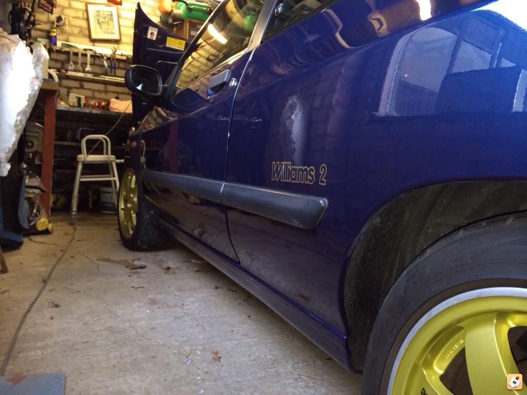

  williams clio
just put mine in today for the winter wheels off battery off & give it a good old clean inside & out already for next year
