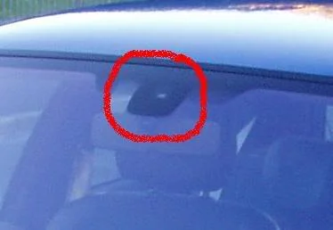

Of course the PH2 172 came with auto wipers .
Do a search for gel pack walshyclio , if you've had a replacement windscreen then it might not have the gel pack . See the pic .The gel pack looks like a few blobs of clear silicone sealant .
