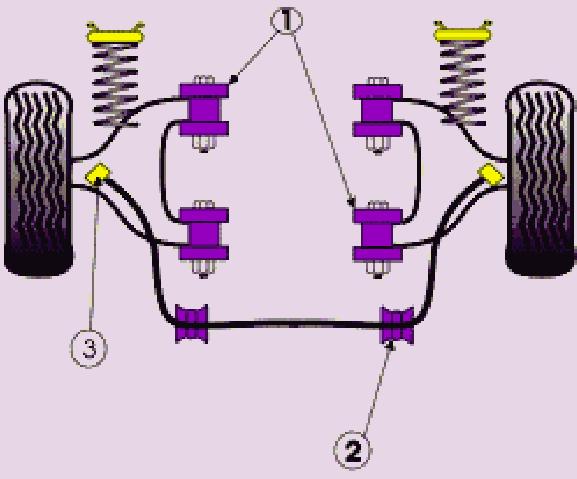

Pat_986 1996 Valver Feb 16, 2006 #5 You will have anti-roll bars. Wheel off. Undo roll bar with large torx bit (t40?) and 13mm(ish) spanner on the bottom. Undo bottom ball joint....if you dont have a splitter I would undo the two bolts that hold it to the wishbone. Then undo the two large bolts holding the wishbone to the subframe. As above.......replace the anti-roll bar bushes at the wishbone point......wouldnt bother with the inner ones as they are a nightmare to fit. Hope I havent missed anything! Attachments Po.webp 28.2 KB · Views: 48
Pat_986 1996 Valver Feb 16, 2006 #6 Replace number 3. Number 1 will be included in the new wishbone's 2=nightmare!!
