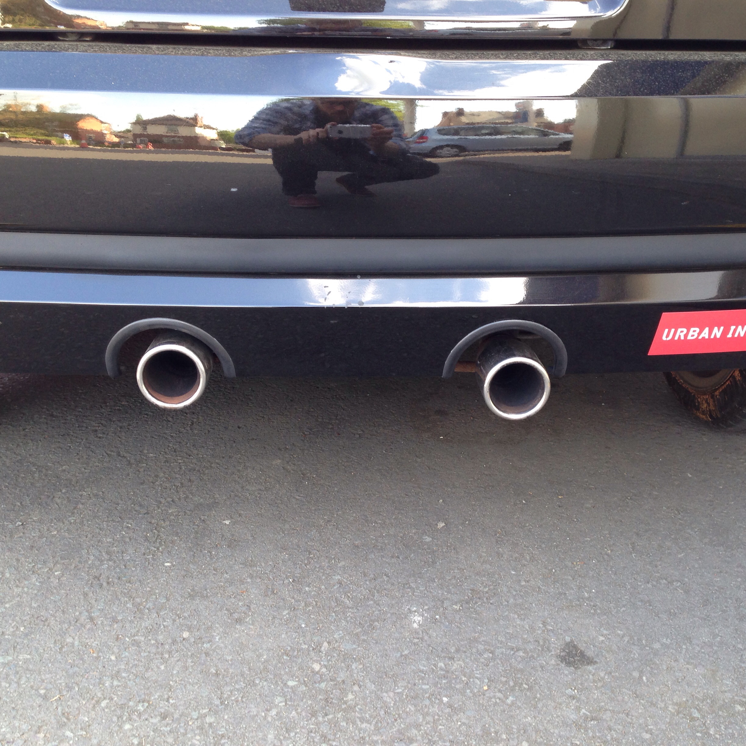

Anyone got any ideas on what this is.
I have a 182 and standard exhaust setup. the exhaust was off centre (to the right) and right pipe sitting lower.
I've changed the rear exhaust mounts for new ones and has centred them up a little but right tail pipe still lower than the left
any suggestions? i know there is a mount in front of the right silencer, could it be this? has anyone else experienced this?

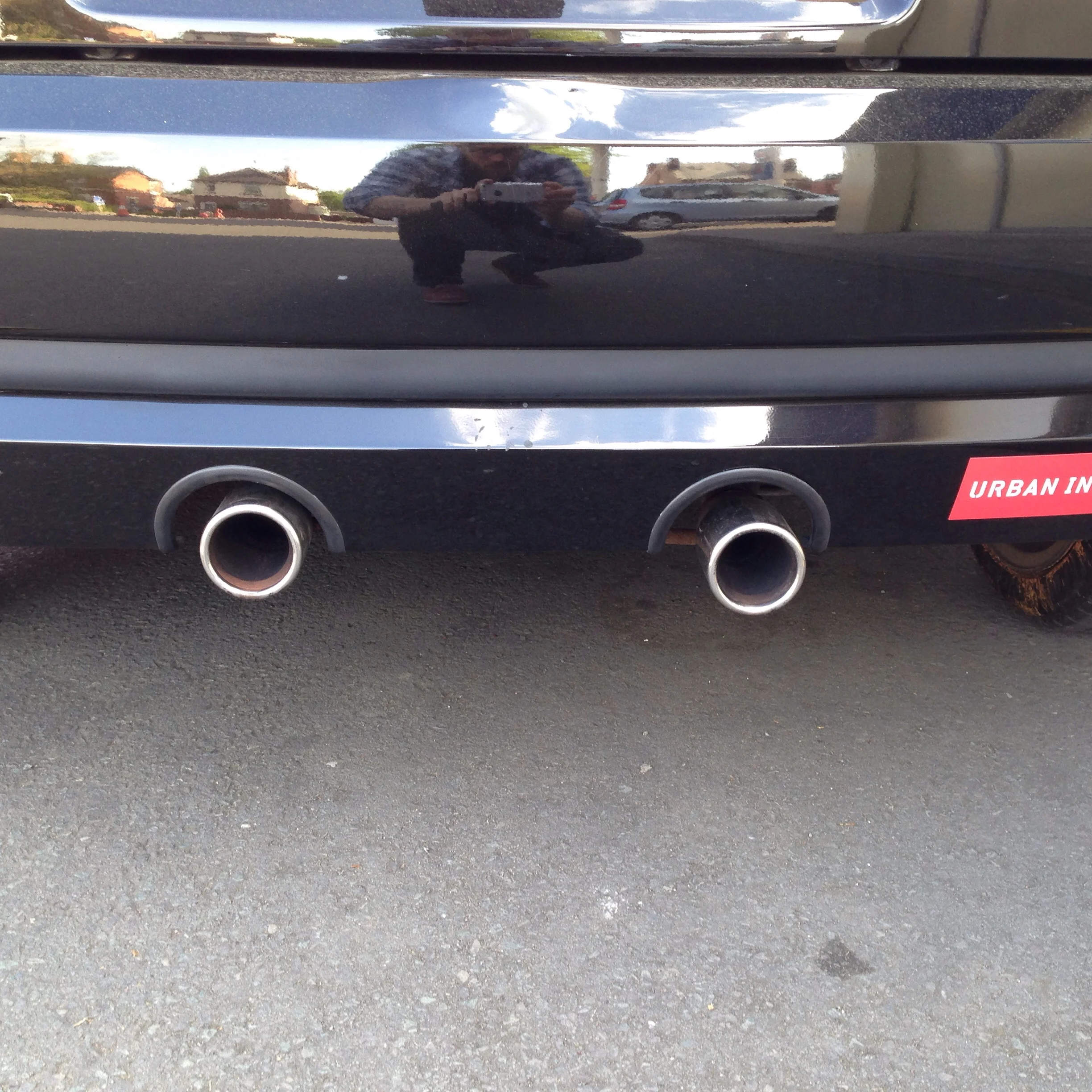

This is my problem
You need to space the rubber hangers out with thick pipe or sockets. I changed mine and mine weren't straight. It's trial and error but once it's done it's fine. I've got pics in my thread it's about half way through

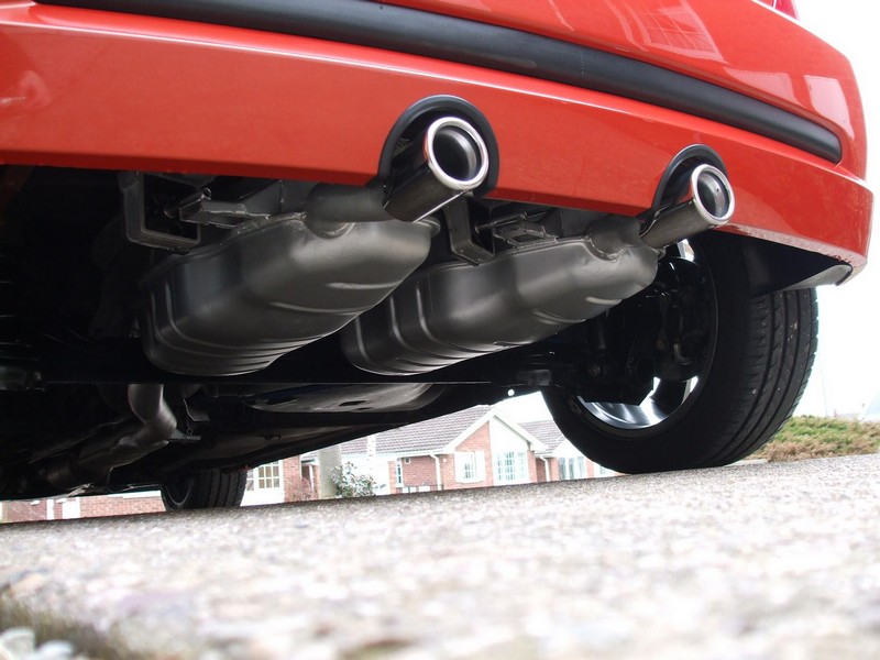

I would just like to point out that this underside photo of the little red number is.............arousing.............which is no mean feat on a Thursday.
